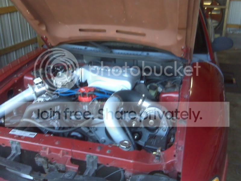

331 DSS stroker Trickflow top end kit stage 2 cam , D1SC procharger 11psi , Detuned to stay under 500 rwhp so it doesnt split the block , tuned with Moates Quarterhorse
475 RWHP 483 RWTQ

Nice numbers, I'm hoping to get close to the 400-450 range, with almost same setup except the 331. What fuel upgrades have you done other than MAF and injectors of course?
2002BLGT
May 24, 2007
345
Bedford VA
Yes I tuned it
Has aeromotive fuel system which is good , but only 42lbs injectors and I think they are just about at their limit , MAF is Delta Force Bazooka meter which is good as well , personally I would like to see this with a newer slot style meter and 60lbs injectors , I have set the rev limiter about 6200 cause its going a little lean at very top end of 4th , stock blocks dont like RPM anyway , this thing would probably do 550-600 rwhp with more timing and aftermarket block and more boost and more injector
