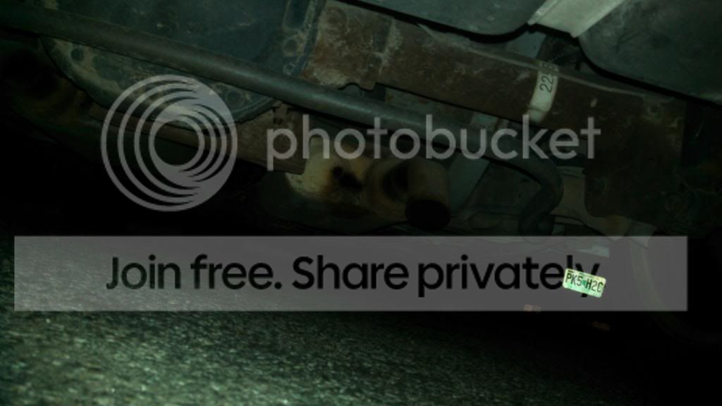

New development in my needed maintenance. In addition to needing a full tune-up.... I also have to get my exhaust done. Heard a creaking/grinding sound when hitting small drops in the road (nothing bad just normal driving) so I crawled under my car to see if I could see anything visibly hanging down or showing grind wear. Did not find anything that seemed to be causing the sound. But I did figure out why my exhaust just sounds drone-y...
The back of the mufflers are rusted out...
Drivers side:
Passengers:
So it looks like exhaust has jumped up from #1 on my want list, to #2 or 3 on my need list...

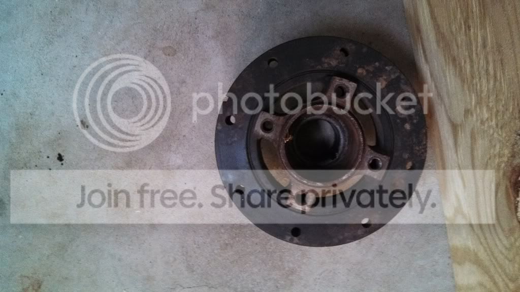

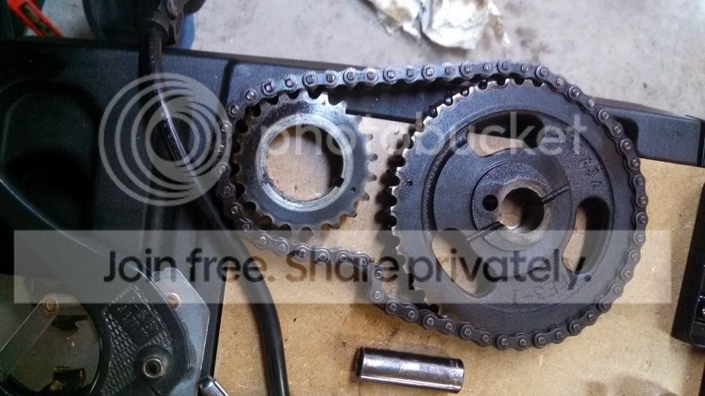

Semi-finished my timing cover gasket job today....
Put on a new timing chain/gears. New timing cover gasket w/ rtv to be safe. New water pump. And new Harmonic Balancer. Got everything offwith only one small hitch, previous owner stripped the bolts on the hamonic balancer pulley. So we had to drill them out. After that everything went fairly well. Got everything put back in. Finished getting everything hooked back up, changed the oil to be safe (didn't want to risk having any coolant or anything in it). Then I went to fill up the radiator with new coolant, and the lower radiator hose started leaking. So Going to go get a new one tomorrow and hopefully be done with everything. Fingers crossed.
The good thing about this is it gives the RTV more time to completely cure. Bad thing is just I'm impatient lol.
Pics of the result (before replacing hose):
The OLD Harmonic Balancer:
The old Timing Set:
