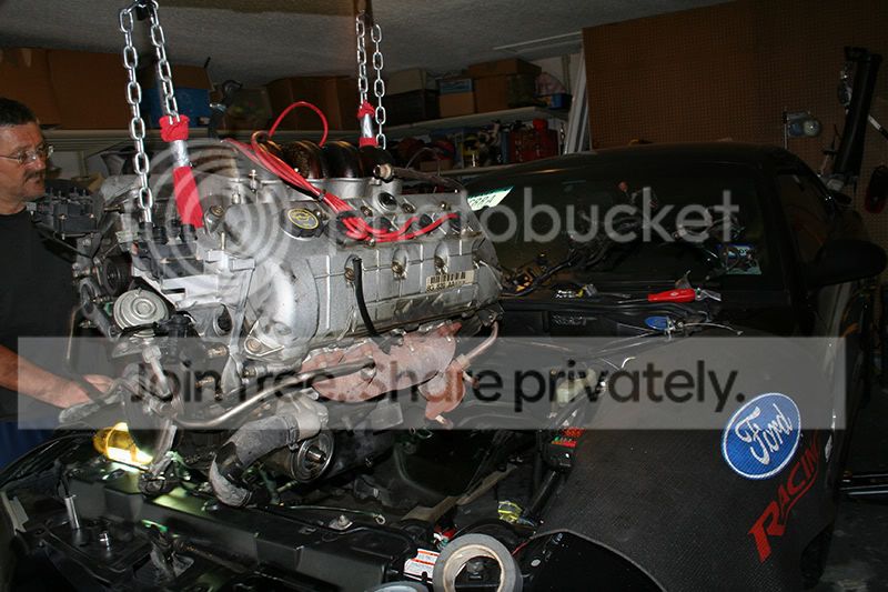

okay guys, well i just got in from the garage, motor is out, kmember is out, front suspension is out, brakes are out, tranny is out. everything is totally out of the car right now. tomorrow my dad and I are bolting up the tubular kmember and putting on the front coilover setup. we will also be swapping over everything off my black cars engine onto the new engine that needs to be swapped (oil filter housing, coolant crossover tube, intake, IMRCs, etc..). I am also going to get my spec stage 3 clutch and flywheel balanced hopefully. today was a busy day but tomorrow will be pretty busy as well.
all in all things look good. im hoping tomorrow i can get the other motor completed and ready to be dropped in by wednesday and i hope we can get the Kmember and coilovers setup correctly. I do have pictures of everything and will upload them, right now im kinda beat though. worked from 10am to 6pm on the car sooo.
to answer some questions, the new engine did come WITH a white 98 cobra (not out of it) and it is fully forged. i bought it from the owner of Lonestar Performance here in dallas. my BLACK cobras engine that we just took out will go straight into the white cobra and the fully forged 99 cobra motor will be going into my black cobra. after that, the vortech will be going on in the next few weeks when I get time on the weekend. (gotta go back up to UNT cause classes start monday)

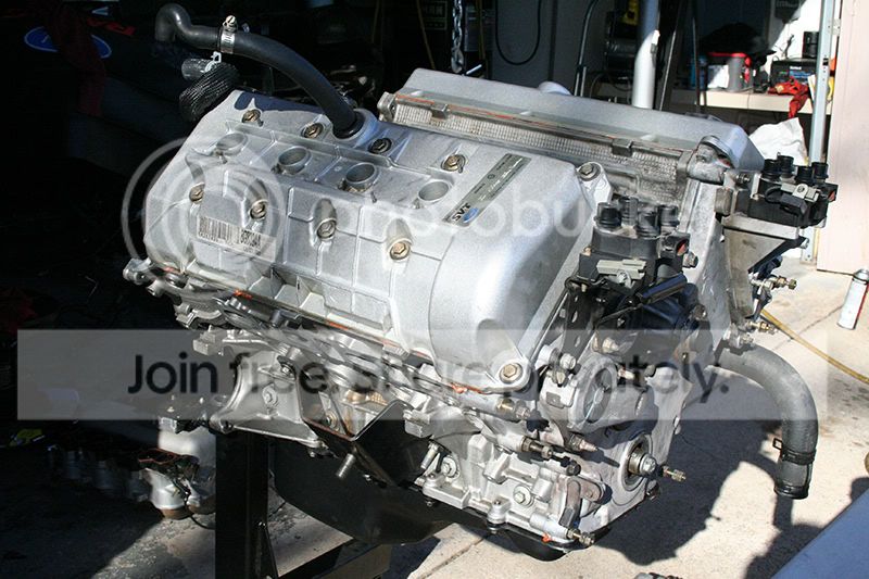

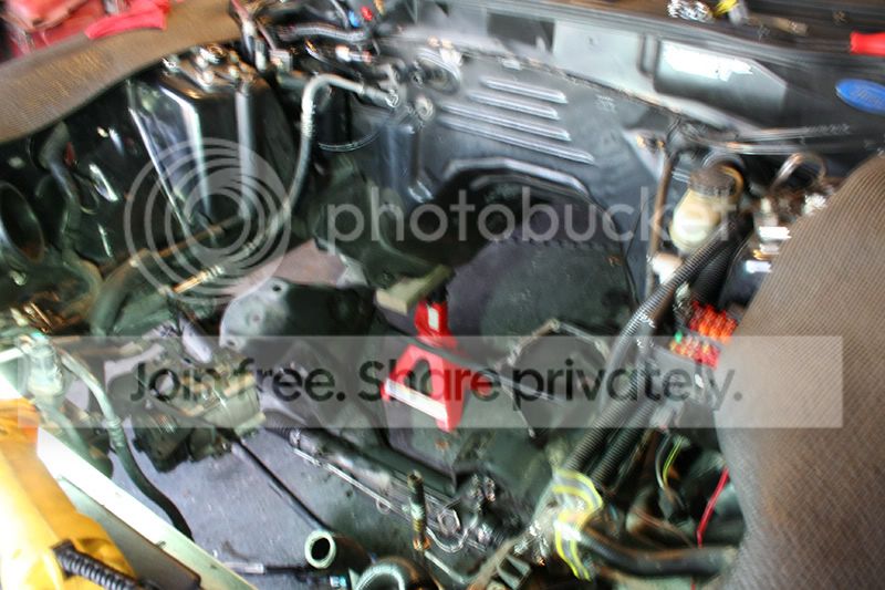

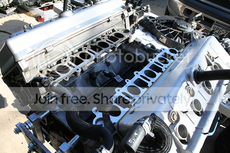

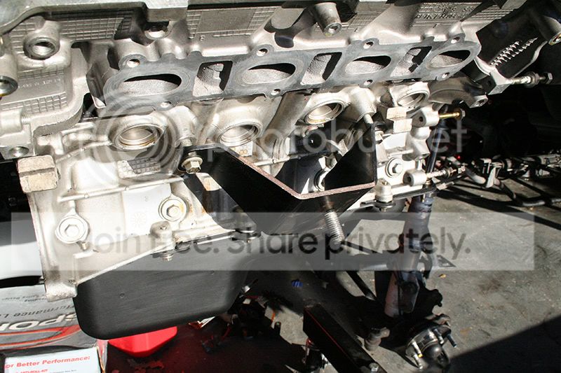

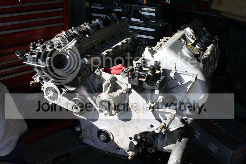

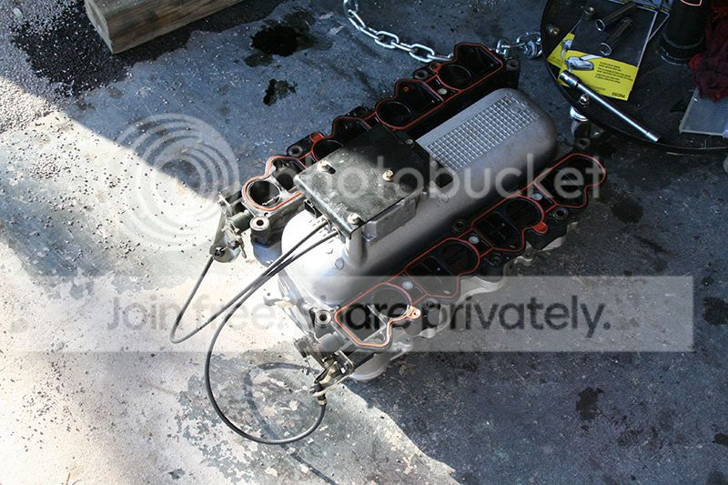

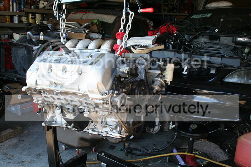

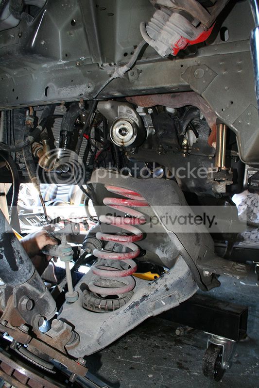

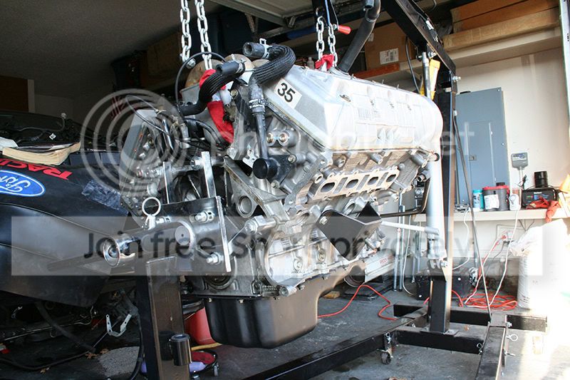

well, motor is complete, just have to pull out the old pilot bearing and put a new one in, put the flywheel and pressure plate on and lower the motor in. should be done by saturday i hope. my dad is working tomorrow and nobody is home so i wont be crawling under the car tomorrow alone. i got everything cleaned up though today and got the intake and IMRC's on. I ran into a problem last night, i guess the knock sensors on a 98 block are different from the 99 block so i ordered 2 new connectors for the wiring harness but they ordered the wrong part, plus they were 35.00 a piece so i just straight wired the knock sensors to the harness, no biggy. but, everything is close to done i believe. got the solid motor mounts mounted up, dipstick, intake, whole front timing chain cover with the power steering reservoir, tensioner, idler pulley, crank pulley (still needs to be torqued down), and coil packs. valve covers are on too. soo im pretty excited.
just gotta lower the motor in, mount tranny, do my longtubes, mount kmember, mount the motor, finish mounting AC compressor and power steering pump, finish up wiring harness, and drive the hell out of her! im sooooo excited!
oh and gotta run wiring for the wideband AF gauge anddddddddd b o o s t gauge. :headbang: :headbang: ill be whining soon ohh yeahh
old engine
ready to go in
my poor, lonely, empty car

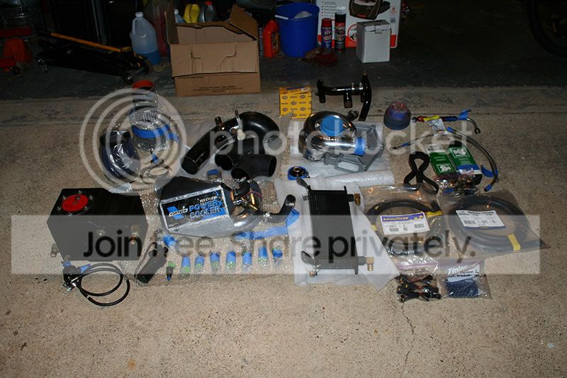

and my next mod for good measure and those that haven't seen this yet. will go on in a few weeks!
