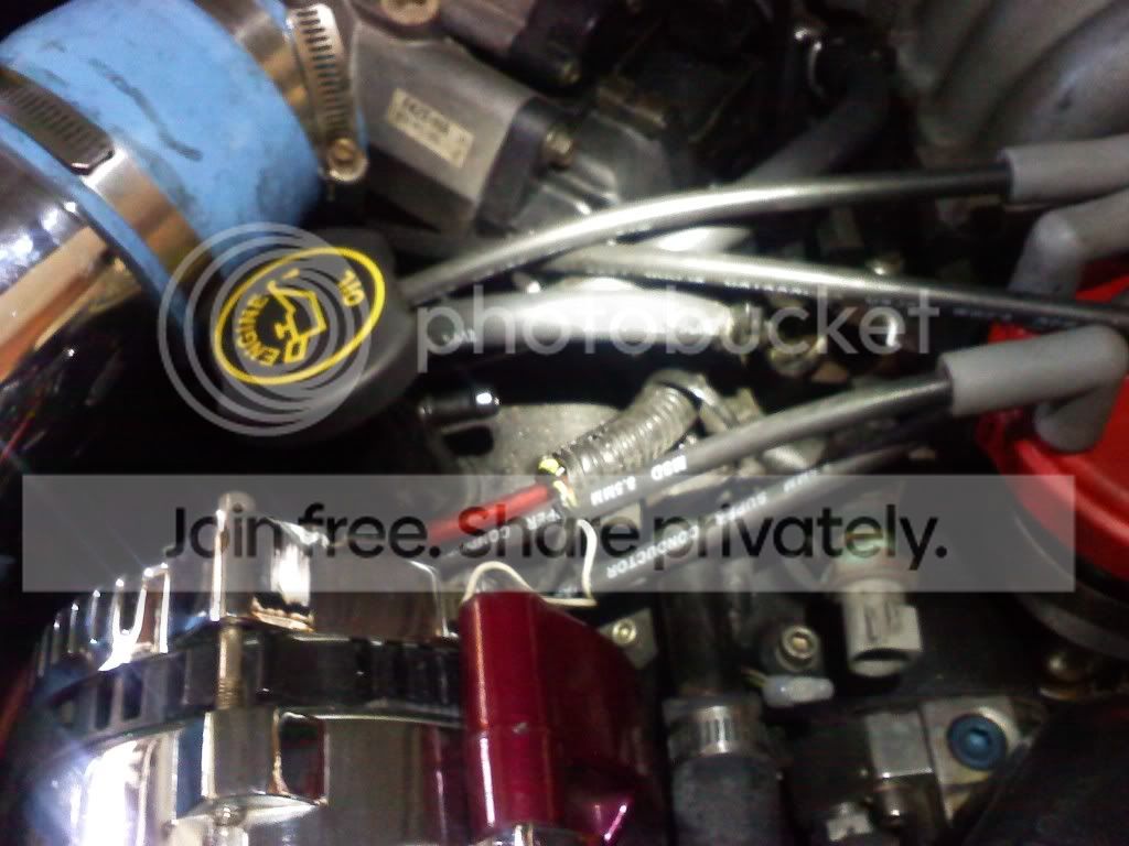

so you can see what i was talking about :)

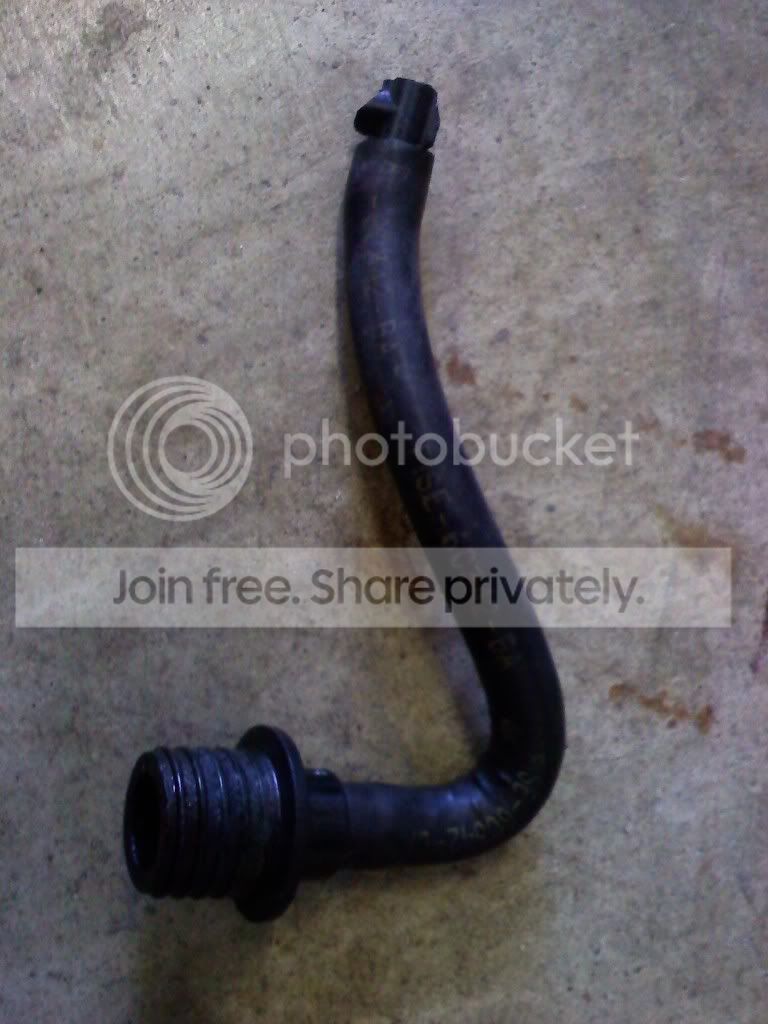

there is a little hole in the chromed section of pipe right next to the nipple on the filler neck, just cant see it here. the coolant temp sens wires are capped :(
since the tube was missing from the filler, i figured i'd see if the pcv was even intact. well....the one way valve works....but i think that tee....is pretty useless now.
EDIT: After digging deeper, the guy before really has hacked up the pcv system. i want to return it to a closed system, mostly for my peace of mind, but i cant find a stock routing diagram of any sort, either in manuals or online, i just know it goes from the valve to the intake, which he capped off, on both the underside and the drivers side. so i'm kind of at a loss. any help is appreciated.

does your fan come on. i doubt he swap over to the fox. your car will run like crap with out that sensor. pcv is an easy fix just get new hosesand a t it should hook up at the back off the intake and t off to a place under the intake. mine does anyway.

yeah, my twin electric fans work great, and...the car seems to run fine to me, but i could find any type of relocated sensors, just that unconnected one, and the one for the dash gauge.
yeah, i plan on doing the pcv monday, all the components are still there, just NOTHING is connected.
out of curiosity, while searching i found that the second nipple on the bottom side of the intake is for.....the purge regulator or something, right?...how bad is it that he capped that pipe off as well?

sucks the gas fumes from your charcoal canister. so you have after market fans. you still needs that sensor to adjust A/F , timing and egr according to the temp on the engine.
