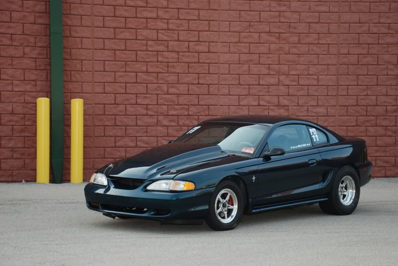

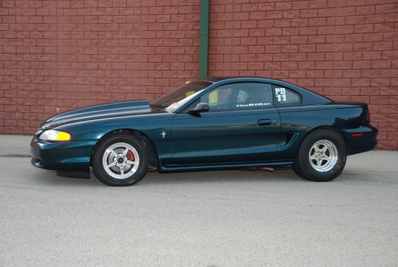

green hornet what size tires do you have on the front i have a 95 with weld rt/s with 15x4 front and 15x10 back with 6.5bs looking on going 28'' et drags slicks in back but im trying to match front.
Green Hornet
Jul 6, 2010
380
the fronts in the pict were futura tires. cheep ones for running true street for a legal tire. otherwise i ran m/t front runners.
