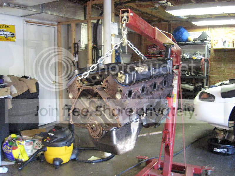

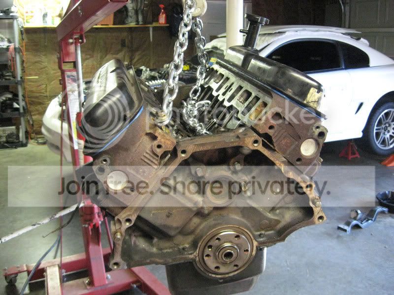

Few pictures of the old engine out of the cobra....
idro
240

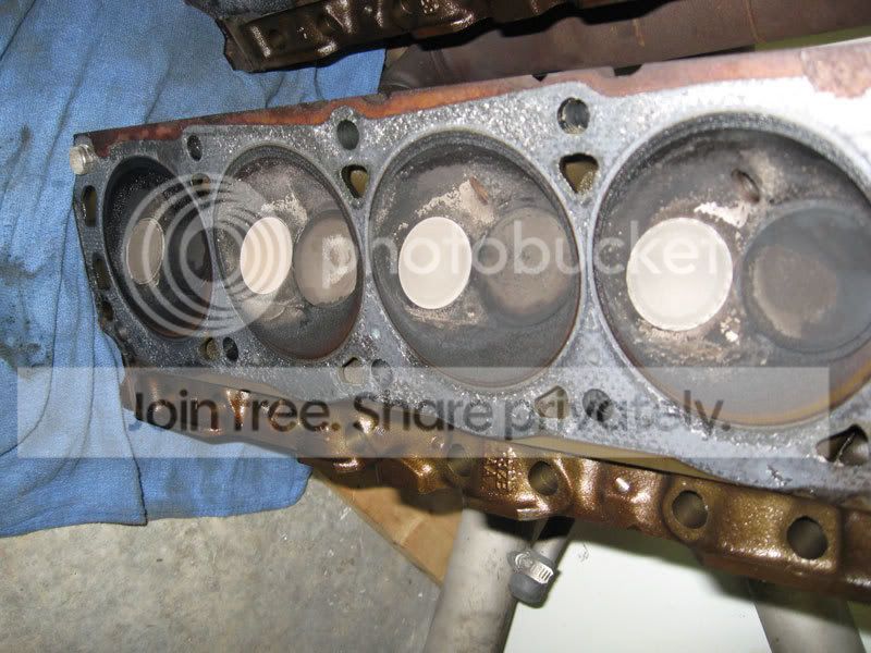

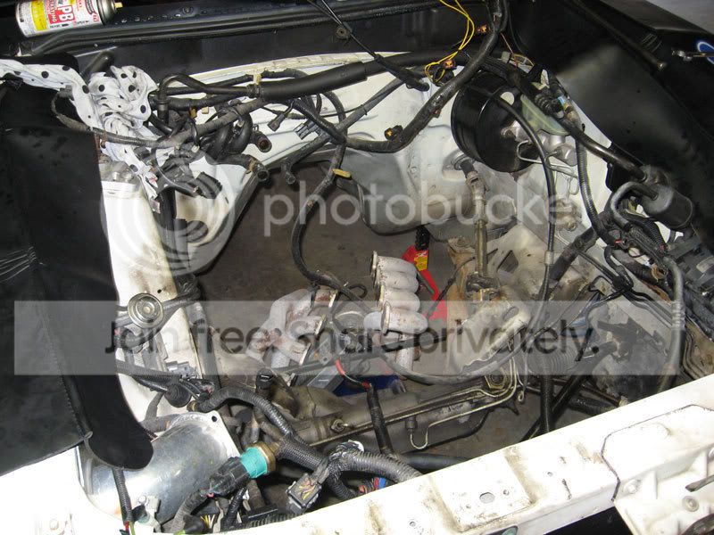

Took the time to take pictures of the old engine... In the process of building the new right now but yea this is what i had before....
Yea, empty engine bay....

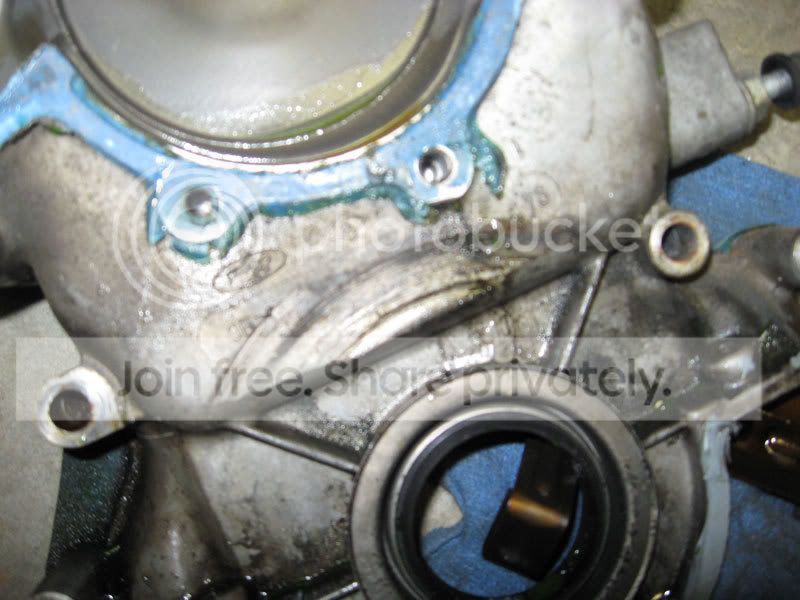

The mains were so wore out that the balancer was eating through the timing cover... Yea timing cover aisle 7 here i come. :(

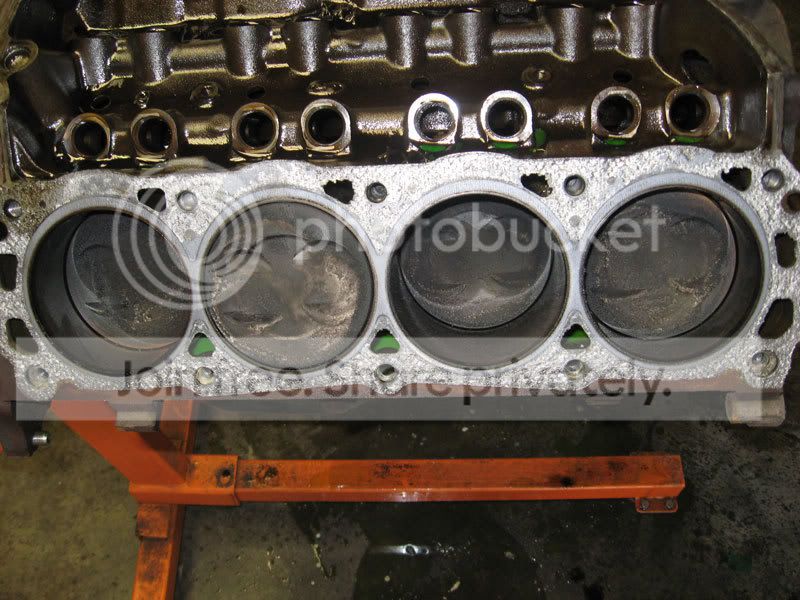

Can't really tell but the sides of the pistons look like ice cream cones and are pitted like mad. The block walls are gapped like mad aswell....
Head valves were fvcked aswell but im keepin the stockers...Took them to the machine shop and just got them back.
Long story short, the idiot who had this car before me didnt know how to jet nitrous to save his life and you can tell from it in RL but i dunno if you can tell from my shoddy picture taking skillz...
