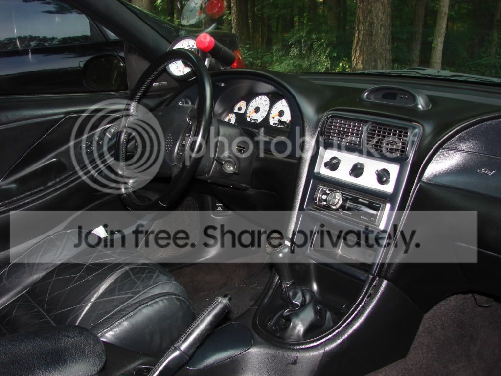

This huge tach on the dash in the picture below is honestly, in my opinion annoying as hell. Where do the wires for it typically run to under the hood and again, what's involved in removing that?

and finally for the tach. its probably drilled to the dash... simply remove those screws. then follow the cables under teh hood to where they are spliced into the wiring harness. Usually they run the wires under the dash by the pedals. If you look under there, you can probably find a few wires that dont look "factory."
if you look under the hood, on the drivers side there is a big rubber boot. thats usually where they cut open a hole to run the wires into the cabin compartment. if that boot is in original condition, with no crazy wires sticking out, someone more knowelegablelbale will have to comment to help you...
but if there are cable sticking out, you can probably follow them and find their sorce in the engine bay to properly dis-assemble the wiring for the tach.
also, if you car has a sub woofer sound system (aftermarket.) you can probably follow the cables they ran on that into the cabin. I know i run my gauge wiring right along side my sub woofer wiring.... maybe the previous owner of your car did the same.
