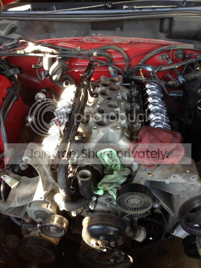

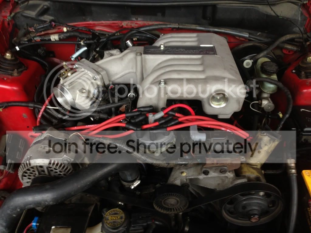

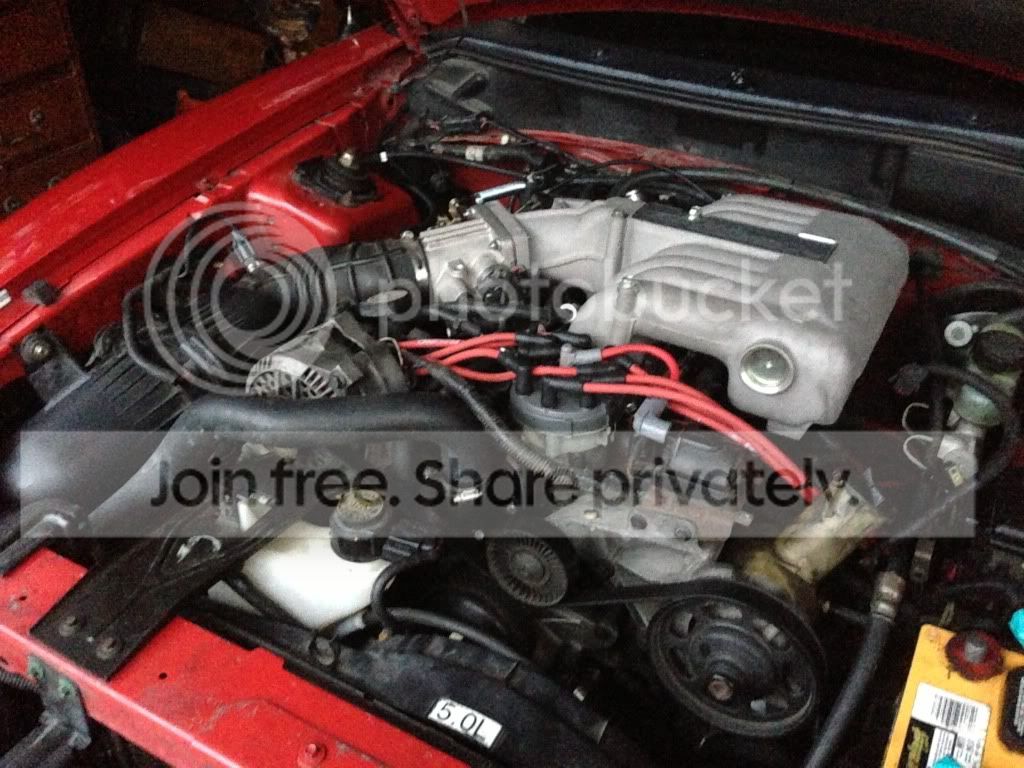

So my plan was to get some mods done before I started school and before race season was over. Since I first owned the I immediately started collecting parts and now I put them all on yesterday, haven't started it yet but it'll be done today.
the mods:
cobra intake w/ 70mm throttle body
180* thermostat
1.7 crane roller rockers
ford Motorsport shorty headers
A/c deleted
and fuel pressure regulator.
It was a pain in the ass just because it's an old motor, for example the first lower intake bolt broke in the head luckily my dad drilled it out and we put another bolt w/ a nut.
But anyway, here's some pics of the final finish;
