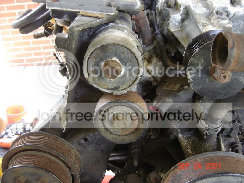

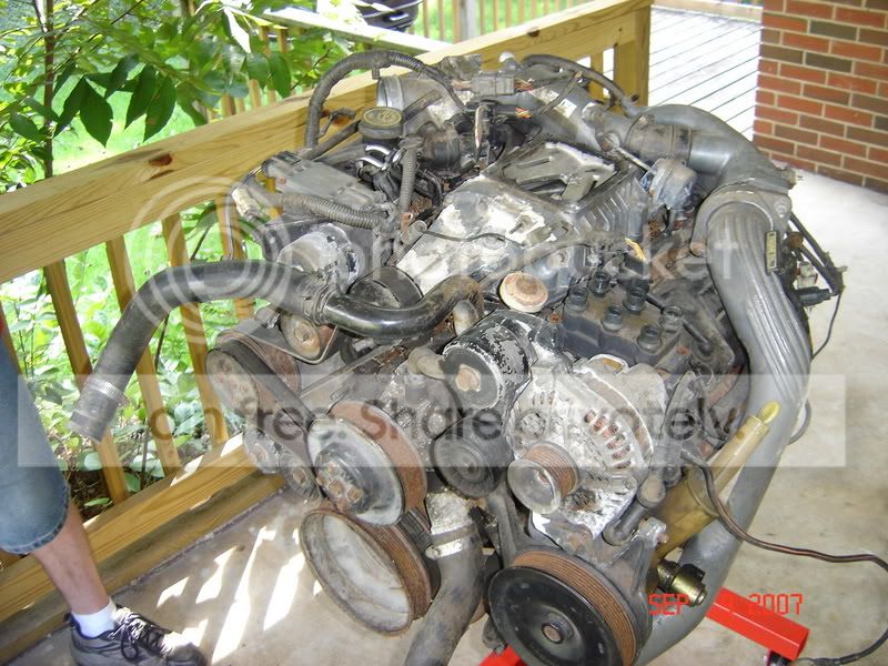

I finally managed to get my supercoupe engine to my house this weekend... :dancing6: and yes Kids I come bearing PIX: :bunny3:
this is what I got
Rear shot
pullies and bracketry shot

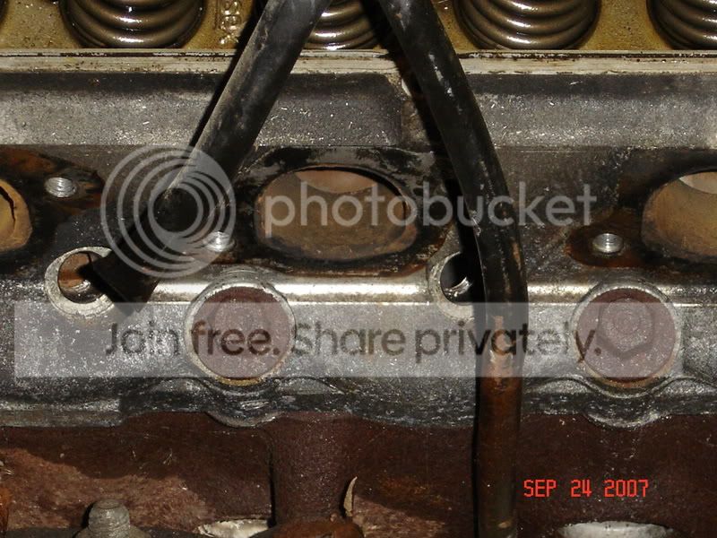

Head shots (detailing the plug in them as I believe they have some work done to them)
and a blower shot w/the upper taken off so you can see the condition of the rotors
I do not claim to be a photographic genius but I will update w/more pix as I progress, I have started tearing down the engine but alas, I am at a stopping point due to the lack of proper sized torx bits for fuel rail removal and a longer socket extension (which I will hopefully have by this weekend so I can continue) :hammer:

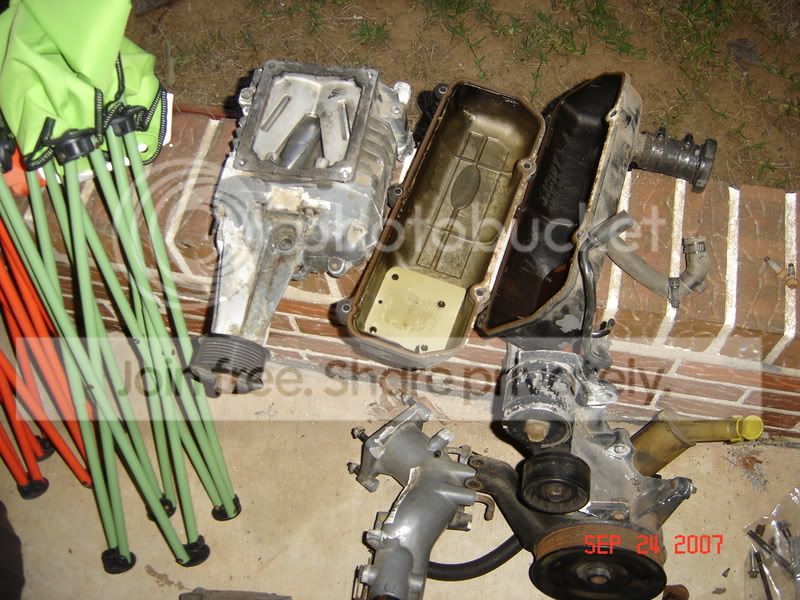

Ok managed to get a bit done today, would have gotten more but I had a driver blow a headgasket, and had to go pick him up. Thus my time was short. Basicly I got it down to just the Heads, Lower Intake, Water Pump, Timing Chain Cover, Oil Cooler, and Internals. All that damn Bracketry was STUCK on like a mofo... :slap: Remember Kids... PENETRATING FLUID is your friend, weather it be WD40, Pene-Lube, Or Penetrator X, use it liberally. :thumb:
I will Attemp to get it down to just a block and internals on Thursday, but with my luck.. who knows what might pop up.
Now on with the pix:

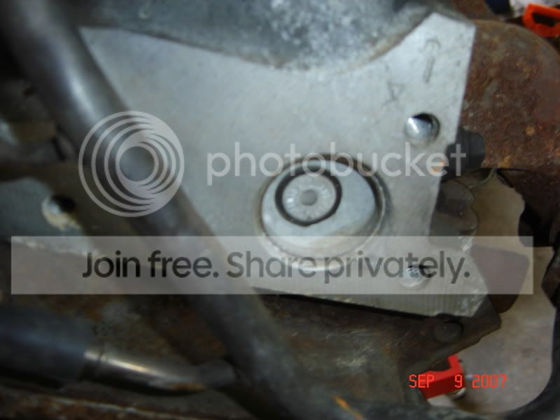

could you do me a favor and take a good pic of how the SC dipstick tube mounts to the exhaust manifold bolts? i need a SC dipstick tube and just want to make sure i get it on there the way it belongs.

One of my tabs was broke. But the other is intact and I can get you a decent pic of the bolt it goes on w/whats left of the second "arm" that mounts it to the block. I'll see if I can go get it now. Will edit w/update.
::Edit 4 pix::
The tube into the block
If you can see it how I see it in my minds eye the "arm" extends to the back of the exhaust that bolts to that port on the right bolt. A double nut if I remember correctly
The Farthest exhaust bolt in this pic from a slightly different angle
Best Closeup of the port in question. The "arm" bolts to the exhaust bolt hole upper right center in this pic
Hope this helps man.

so it's attached to the upper exhaust manifold bolt on cylinder #4....thanks man!
