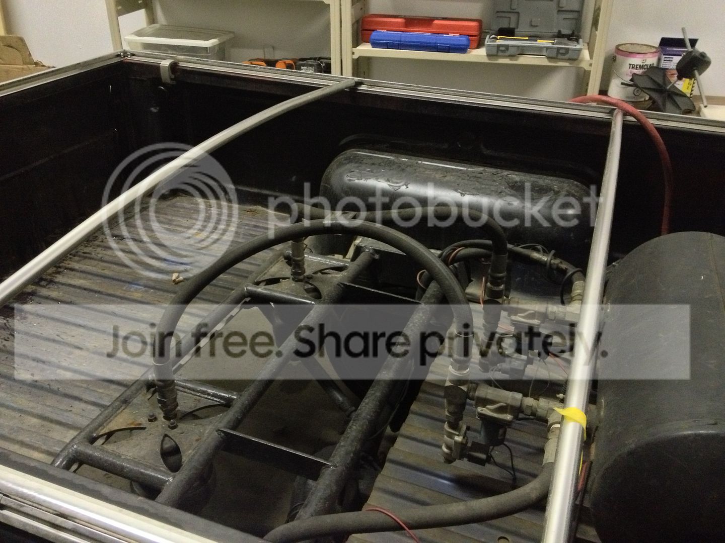

This is from before I cleaned up the wiring today. But you can see the bags mount on the rear 4 link bars
i see some suicidedoors.com parts in their, lol. good place to get air ride shit if ya ever need anything. plus if ya ever have any ??'s i'm right here my dude. only thing i would suggest is some water traps. they would go right behind those fittings going from the tank. w/o them that tank is gotta be full of water. not a huge deal but can suck when it's cold cause your valves freeze shut or open.
edit: i forgot they changed their name to qualityairride.com, lmao. heres a link to the water traps if ya decide to get them:

Yea there was for sure water in the tank when at home because the front right would stick open so the truck would drop really quickl when raised. The setup is so quick with those lines
