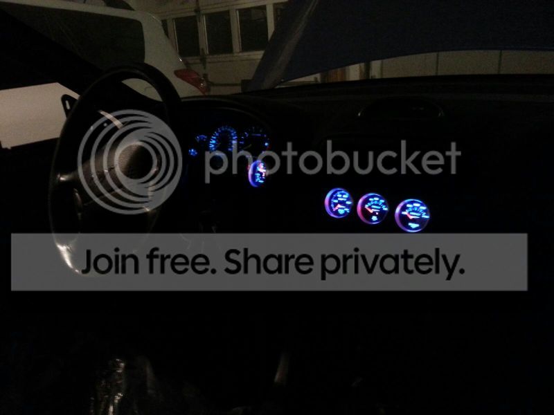

2slo95fiveoh
Dec 31, 2006
2,559
Lawrence, Kansas
The left most gauge in the center dash portion. One of my favorite changes to the cars interior, and I feel a little better about driving it when I can view more of the engines 'information' than the sad excuses for factory 'gauges'.
