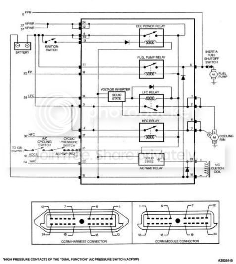

Hey, guys been having an issue. Recently finished an HCI on my 95 gt. it started up fine, idled fine, sounded great. I turned it off to clean up my mess of tools, and gasket boxes, and when I tried starting it again... The pump wouldn't prime. Just a clicking coming from either my CCRM, or somewhere around there. So, I started searching. Changed the Ignition Control switch, checked fuses, made sure I was getting power to the pump, the inertia switch. Then I went to the connector for the CCRM. I am not getting power to pin 8. Which is what I believe to be the one to the EEC. Pin ten isn't getting power. Pin 18 reads .33. Pins 3 and 11 read out 12v, pins 17 and 18 also read .33. And 24 reads 2.34. I have no idea what I'm doing when it comes to electrical problems. If anyone out there can offer up some help I'd be eternally grateful.

That's not the lay out for a 95gt on the above pic..
