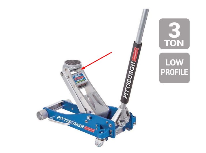

My daily is a 2018 F150 and I keep large and small ratchet straps in there depending on the load I'm hailing. I ratchet strapped a 2x4 that I custom cut to my jack then used smaller straps on each side to the 2x4.
I don't know if all floor jacks have an opening in the middle of the lift arm and pivot part that makes contact with the car but my aluminum racing jack from HF did.
The balance is going to be wonky but go slow. You could also use jack stands to lower the tank onto if you have the car high enough. A second set of hands helps the most.

Ah gotcha. Ratchet straps are cheap at HF or even amazon. Here is how I strapped the 2x4 to the jack.

Didn't even think of that. That'd be a ton more stable. I was just using what I had already on hand.

I didn't even think of your way. I think my jack does have that gap. Good ideer.
