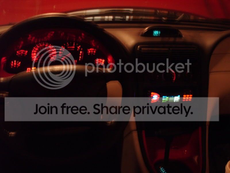

ok, so im know this has probley been on here be for but i was wanting my gauge cluster to be red... how do i go about doing this?

you have to sand the green off the back of the guage cluster and put in red bulbs

Well your lights are green because the film behind the cluster is blue and the stock bulbs are yellowish. BLUE & YELLOW = GREEN. Just peel/scrape off the green film, then pick any color bulb and that's the color your cluster with have.

just take a butter knife and slowly peal the old face off. Just make sure you get your needles back in the right spot. i sanded it with the pocket knife i had.lol just use sand paper though.
