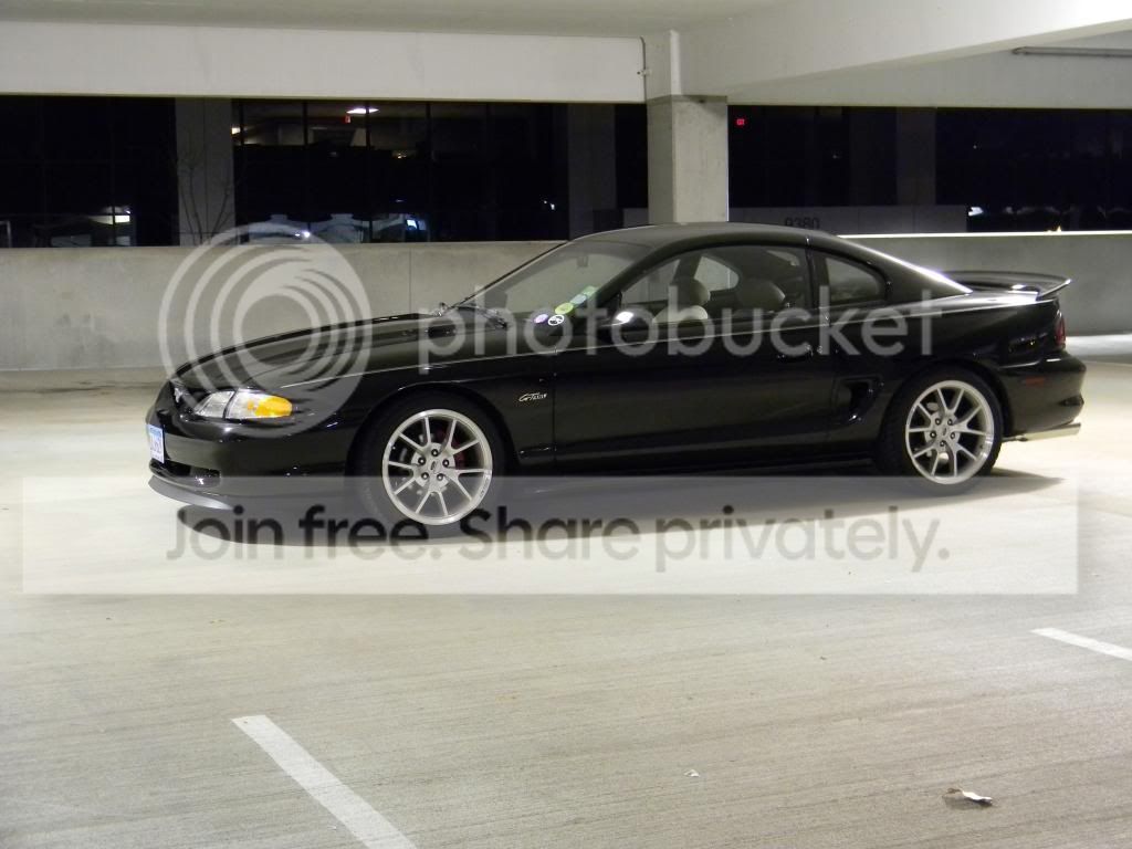

Agreed with many that coil overs are your best bet OR bag it like Tony & ttocs. The way I did it is coilovers up front and the adjustable rear control arms for the back.
I don't have any real good picture of mine with the perches lowered in the back but hopefully you get an idea
Edit: I went out and tried to take better ones:

Yeah i was so excited when I got my coilovers cause that meant i could actually use my adjustable lower control arms without making the car look stupid lol.
Steve that's pretty low in the rear, what size tire and do you have any rubbing? I get some around hard left turns at the right rear...
