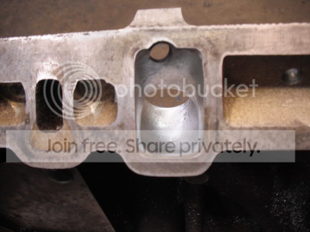

The tfs 1 cam works great with ur combo. I'd port ur lower a bunch before putting it back together and get ur heads ported while ur at it. We're you running stock injectors ? 24's would be a nice addition . The gt40 setups can put down nice numbers

Agree. Port the snot out of the lower. I used a good bit of epoxy on it too.
