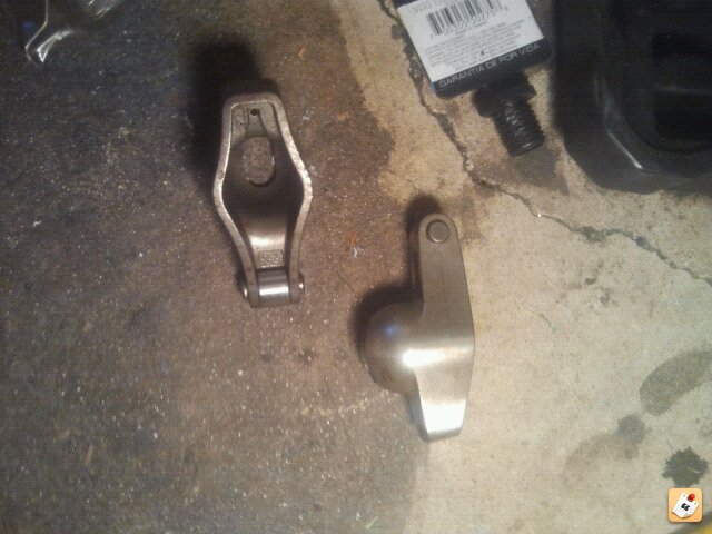

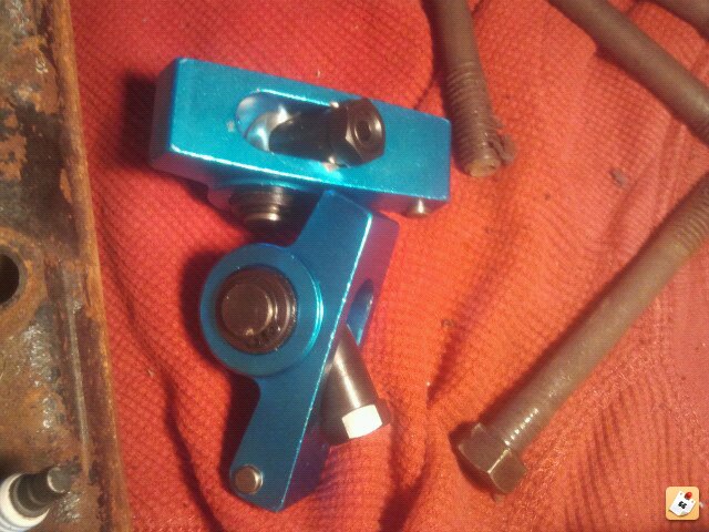

So heres a picture of the studs that i dont know how to get out. Im pretty sure theyre just treaded in but theres nothing to grab onto to twist them out... Am i looking at it wrong? And heres a picture of the aluminum rockers that he gave me with them and the silver ones are supposed to be the stock ones... this guy i bought them from is not really a mustang guy but im pretty sure they arent stock, they look a whole lot better then the ones that came off the E7s. Any ideas?

Are you talking about the studs in post #23? If so, there's got to be a way. Anyone with specific experience? One way I know of for similar situations is to use two nuts, thread one down on the stud, then another one after that. Tighten the top nut until it contacts the bottom nut, then use two wrenches to tighten the nuts against themselves - the top night you will tighten, the bottom one loosen. They will get tight against each other. Then loosen just the bottom nut - if it's done right, the bottom nut will not be able to move up the threads because of the top nut, and will end up turning the stud instead.

dont take the studs out. the blue rockers are a much better part than those stamped steel rollers.

I know they're better but id have to buy a new two new stuff mounts and new push rods, ill so that in the future but I just want the car
Back to running a soon as I can

And that seems like a good idea! I don't know why I didn't think to do that with the two nuts.. I'm about to go try it out!
