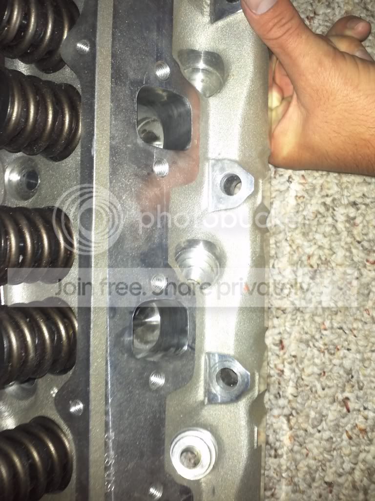

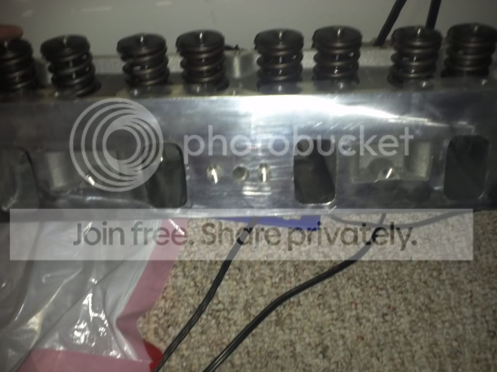

No i understand what he is saying and i say it's bullshit ...
You can look at it for yourself
I ported them to a 1262 gasket
the heads were opened up a lot and look amazing a good friend of mine owns a machine shop and he even said the port work was perfect...
