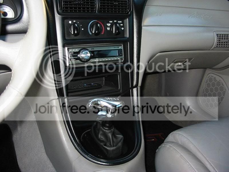

ah cool. yea i'm still a bit fuzzy on the wiring stuff. Here are a couple pics of the shifter that i'm getting, i know that the base is beat up a little but i figure i could fix that pretty easy and with some new paint it would look good as new.
Tell me if you see anything wrong please

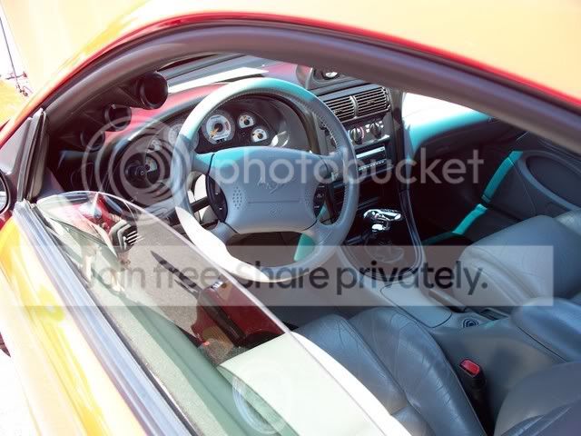

I was looking at some pics of another install and the leaver at the bottom had a thing on it that this one doesn't ... whatdo you guys think?

I have a truck megashifter in my...truck lol. Some of the lever's and crap are aplication specific, they sell you the same shifter for your 470rw that they sell me for my 700r4, so no worries there.
They have instructions on the website that are pretty detailed if you haven't looked there. Unfortunately I didn't bother to wire the reverse lock out, since I was going from a cloumn, I just gound it off and filled the hole with it stuck in park. Now I can start my truck in gear!

Not a bad install. And yes the red button is the overdrive button. Feels/looks 100x better than that stock shifter!
