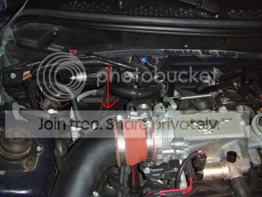

Well, my 98 GT has sprung a massive coolant leak and it is believed to be caused by a failed heater core. I have taken some pictures of where it is leaking from. It is leaking from a hole in the firewall immediately behind the passenger side cylinder head. It is a pretty damn good stream too, not just a small drip-drip type leak.
Here is the general area where the leak is:

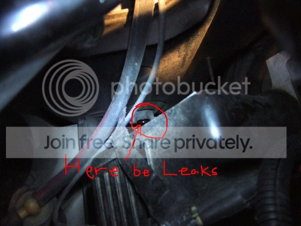

Here is a birds-eye view of the hole (valve?) where the leak is coming from:
and here is another birds-eye view of the hole where the leak is in a different light:
Symptoms include: rapid coolant loss, and the A/C and vent (when the fan is on) air smells like coolant, but it does not smell like coolant when the heater is on. Also, the passenger side carpet is a little damp on the side where your left foot would be while sitting in the car. The carpet is not soaked, but it is damp.
Do any of you have any idea what is causing the leak? Is it a failed heater core or heater core hose? And why is the coolant coming out of the hole in the firewall?

It is most definitely your heater core.
That hole that you are showing is the evap.
If you don't need heat at the moment, unplug your heater hoses and plug them into one another. You can find attachments for this at any auto store.

Lol, it's winter time, everyone needs heat. But yeah, that'll get you by for the time being.

Yeah your heater core is the problem and that is the reason antifreeze is coming out of you evap/ heater box so the antifreeze wont make a too big of a mess inside of your car. Now with your Alt. problem, did they give you the correct Alt.? Even though your Alt. is charging you might have the wrong regulator that is causing your battery light to come on. Just to be safe recheck to see if they did give you the correct Alt.
