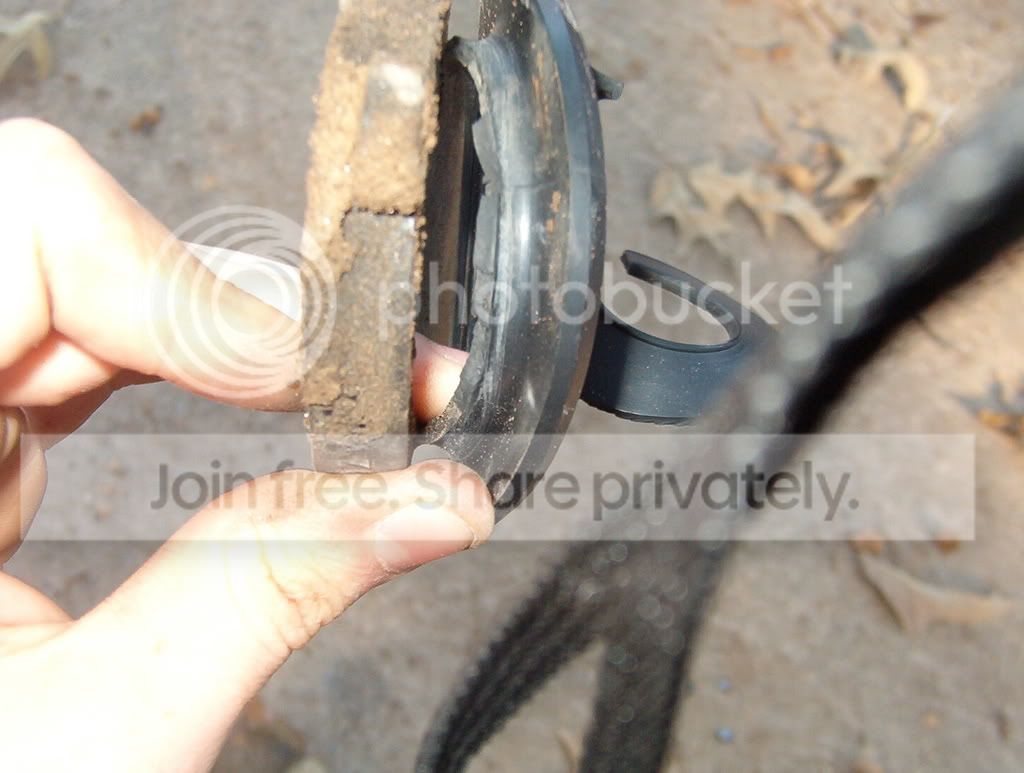

So if anyone remembers me talking about my car smelling like gas/oil, it's a gas leak around the pump spot in the tank, where the hose goes into the tank. The seal seems torn, and it's where gas is slowly dripping out.
sigh.... how do i fix?
It looks like theres only 4 bolts holding the gas tank on??

if you mean the filler tube (where you fill the tank). its fairly easy... just run the gas out... take the bolts loose at the filler cap, take the pump connector off at the top/rear of the tank.. take the straps loose and bring it down. just put a light coat of oil on the seal to help the filler neck slide back in.. its not very hard at all. i recommend to anyone that drops the tank for a pump, etc... go ahead and replace that seal

Hmm... cool, so it's not much work at all. I ran the gas out already, So this weekend i reccon i'll buy a new seal for the filler/tank connection or w/e because that's where it's at.
Thanks a ton bro!

Hmm... So i got off my butt and droped the tank. I took pics and i used a jack to hold the tank steady for a night till the part comes in. Was really easy honestly, i even got to clean all the old gas off the tank for the most part.
Heres pics of the broken seal
