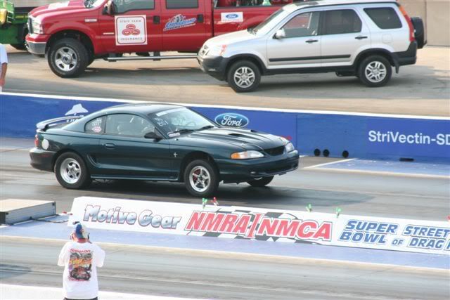

I was wondering what was up with the hood. You can fit a 1/2" spacer and still keep the hood at stock height. Just looks broken the way it is now.
its a 1 inch spacer.
thats really not a good pic of the hood though. i can barely see the color.
ill take one up close as soon as i get off work...

I know you have a 1" spacer, I was asking why you don't go down to a 1/2" so that the hood can close normally? The difference in the two would have to be minimal, but your hood would not look so wierd sticking up in back.

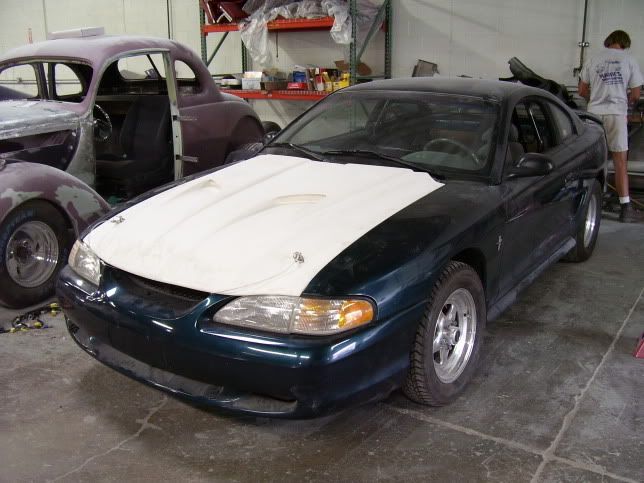

i used to have that hood a while ago. i thogh it was ok.

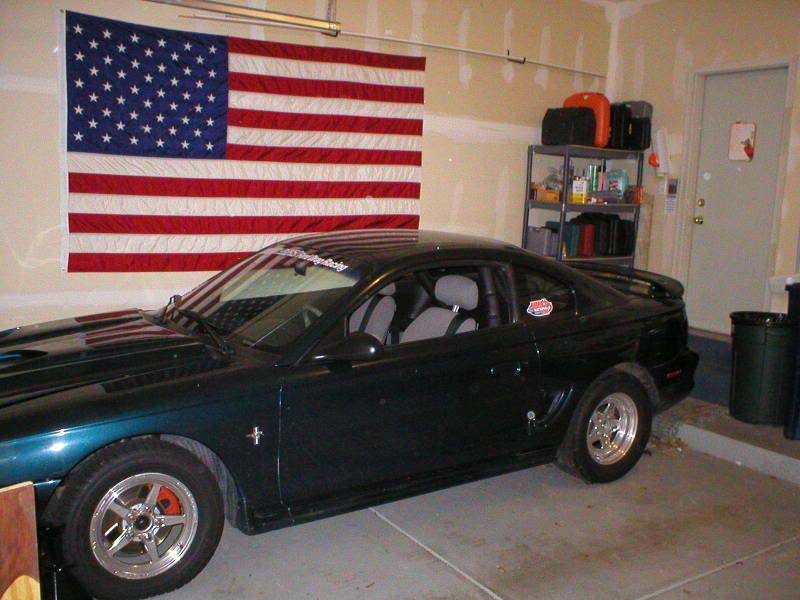

but then i changed it to this

Good god learn to align that hood. It looks like it's sitting on top of a factory hood that's bolted down.
