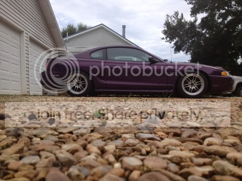

I'm as low as you can go with our cars. I daily my car and the only thing I have is strange adjustable fox struts/shocks cut springs and upper axle housing bushings. This setup rides like stock if not better and still cuts 1.9 60fts on streets.
Damn! Loving the enkeis too! That's so damn low; awesome! Cut springs and still rides like factory? Gotta feel it to believe it. How many coils did you cut off? 1.9 60s still?!

Yes the car does still ride better than stock. The front I prob cut 2 or 3 coils and the rears well let's just say there isn't much left. Maybe 4 coils off. Yes I have the time slip to prove it. I'll admit it road like straight garbage when I cut them on factory struts. Bounced baaad. Picked up a set of strange 10 ways for a fox body and the car instantly road better, with the adjustment on the lowest setting it rides better than stock. This is how I ride daily and drag race. If I want more aggressive feel I just turn them up but it's stiff for daily driving Louisiana roads.
Wow that's a lot of coils haha. I love yours stance though. So JDM brah! Yellow fogs would look sexy if you don't already have them. I've heard great things about the strange 10 ways but I've never had a set. Maybe later if my car ever becomes a track beast.

Thanks it's hard to get the import out of me. No I don't have yellow fogs I was never into the whole jdm thing. I'm about simple clean stock body lines.
