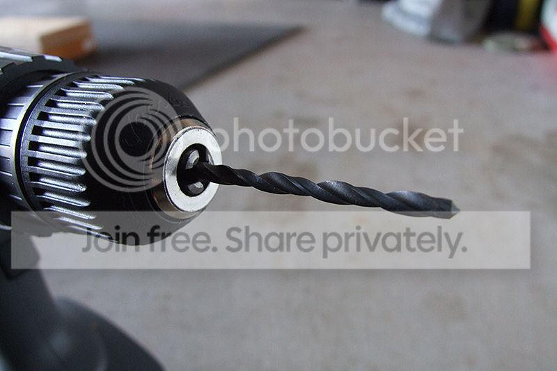

- Drill bits (5/32)

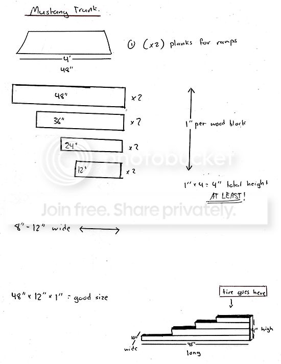

Template:
Step 1:

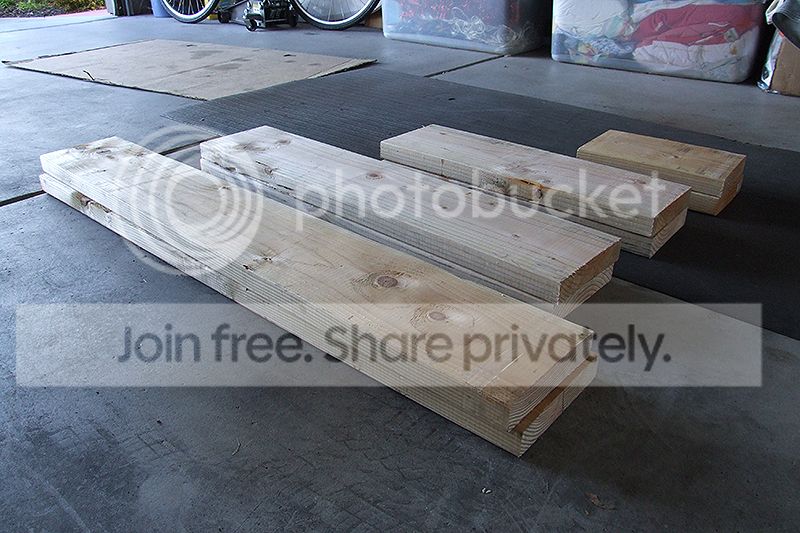

Cut pieces into appropriate sizes as listed above. You should have 2 of each size. (4', 3', 2', and 1')
Step 2:
Start by placing the 3' plank on the 4' one. Mark and make pilot holes using the drill. I used a 5/35 bit for this.
Make sure the holes are spread out evenly. You should make the holes towards the ends of the plank.
Step 3:

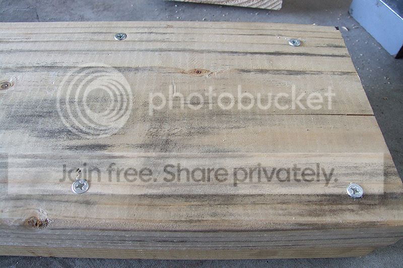

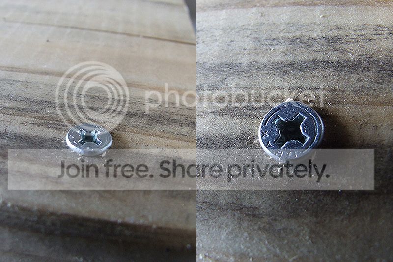

Insert the screw into the guide holes. Make sure to tighten them down by hand with a phillips screwdriver.

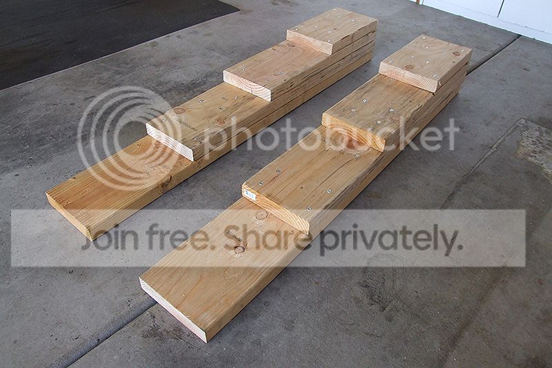

Step 4:
Repeat step 3 with remaining 2 planks. Make a staircase design. Once you are done with each level remember to tighten all the screws down by hand.
For reference I used a minimum of 8 (4 on each end) screws per level.
At this point you have finished building the ramps.

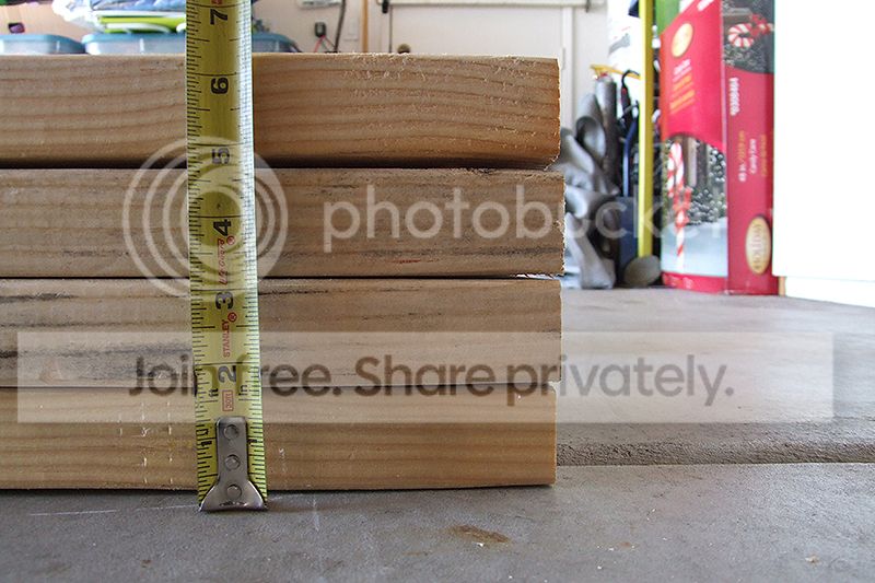

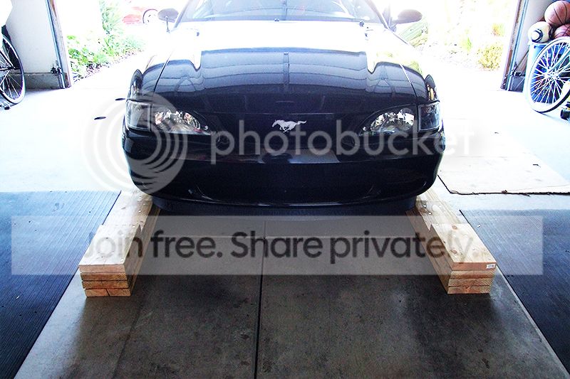

They should give you about 6" of extra clearance.
You can now go ahead and try them out.
I only had to drive up to the second plank to have enough clearance for my jack.

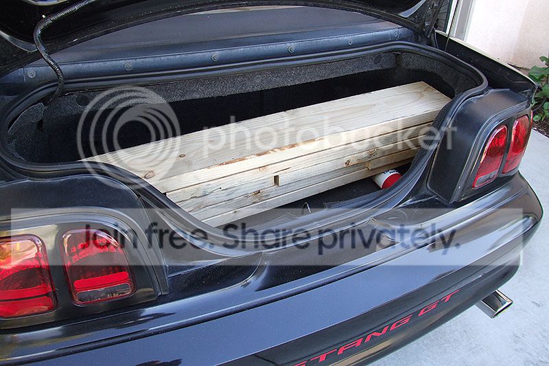

And if you're wondering, the answer is yes, they will fit in your trunk. :thumbsup:
