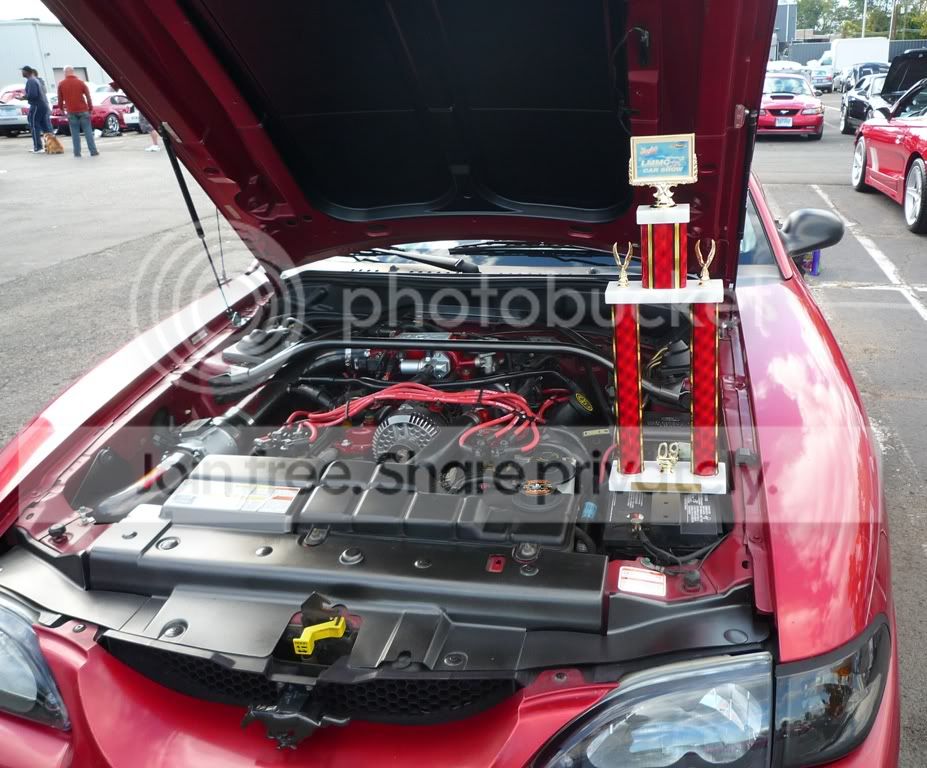

Degreaser, hose and a wheel brush is what I use. May take some time the very first time you are in there but after it's clean it's very easy to maintain.
Mine is so clean I added a little accessory to it

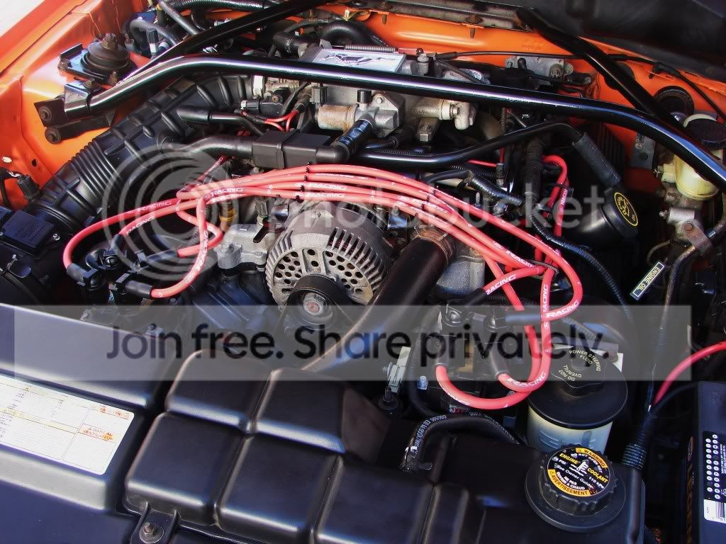

Here are a few engine bays that i have detailed....
The trick is to degrease everything and agitate it all with brushes. The apply a nice product for that brand new look.
