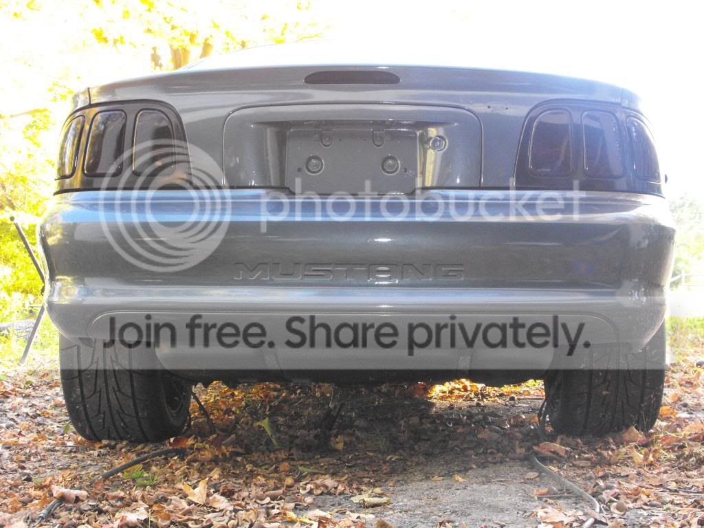

i have 10.5s out back with 315s on them.. It does not rub what so ever and so glad i did cause i love the look of them.
