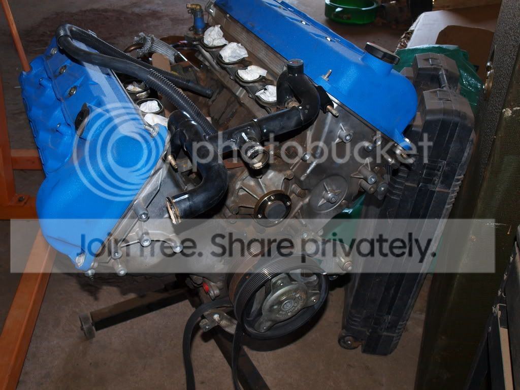

I found a 03 cobra longblock I'm thinking about buying. It comes just like you see it in the picture below. My questions is what would I need to run this in a N/A application? 99-01 cobra intake or Mach 1 intake? 99-01 cobra timing cover and accessories? It also had a ticking sound in the lower end which the owner thinks was a burnt piston skirt, pulled off the oil pan and found a little bit of metal shavings. I figure I'm looking at a new piston, bore/hone and probably bearings while I'm at it. Let me know thanks!

I would go with the Mach intake. You don't need to swap the timing cover. Unless you want to sell it. It is worth about $450.00 and is a very hard to find part when doing an Eaton swap.
With the low compression it wouldn't make much power, I'd look for a stock blower and slap it on there. You can find them for cheap.

I could buy a eaton setup for about $800 but that's just the start of it, and while the whole termi engine swap thing is cool, that is A LOT more work than a simple 4v swap. I'm not worried about not making much power right now anyway. It will probably make over 260rwhp as it is which I think would be more than decent. It will be getting a vortech or Novi supercharger down the line as soon as money permits. So a mach 1 intake is now on my list.
I thought someone said that's what the n/a versions of the 4v 4.6 made, i know the 03/04 runs like 2:1 compression lower...
