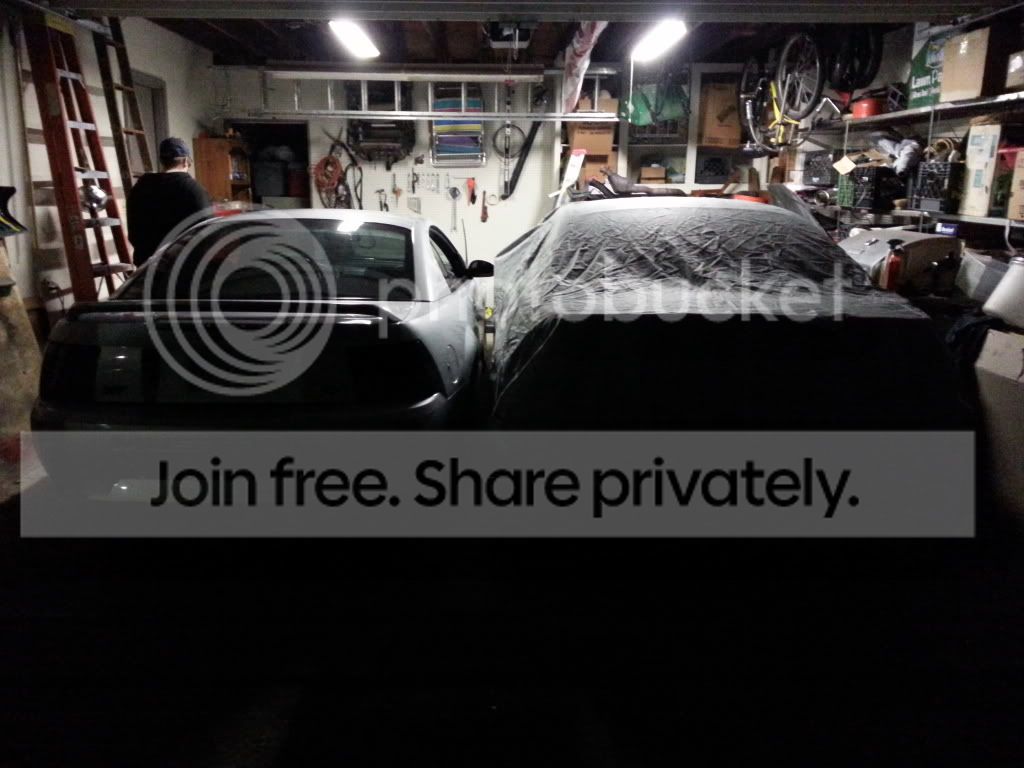

O and this is what it looked like in his garage LOL
Yeah boyee runnin grill-less with not Mach delete lol!

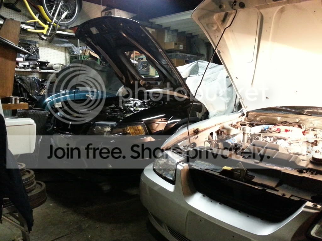

Chris I got your pic comin man gimme a sec..
EDIT: Here's your pic Chris :) My vertigo was destroying me all day, I didn't have the marbles to leave until about 1:00, at which point I still don't think I should have been driving. Here they are at night, in a Wal Mart parking lot! Me and my buddies and even my old man love the tails man!
