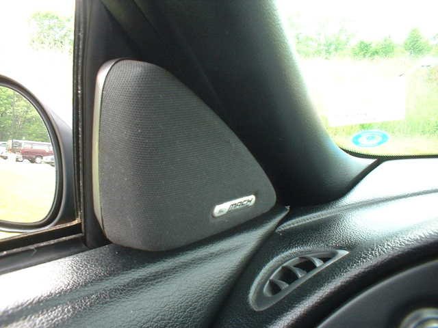

I have the hardtop and i had the extra cd player under the radio/cassette player. I have tweeters behind the mirrors???
Do you have these?

yes if you have a hard top and no tweeters you have 5 x 7's or 6 x 8's(you can use either because of how the basket is shaped) or if you want a little better selection of speakers you can look at round 6.5" or 5" speakers and you would need to make a baffle to mount the speaker in, that then mounts into the car. There will not be a noticeable difference in sound other then from one brand to another. Some people will tell you that a round speaker sounds better then an oval one and that is a bunch of crap. Take a cd you are familiar with into your local stereo shop and listen to every speaker in their sound board and you will find something that will work for you.
