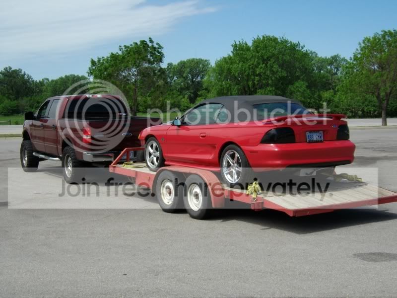

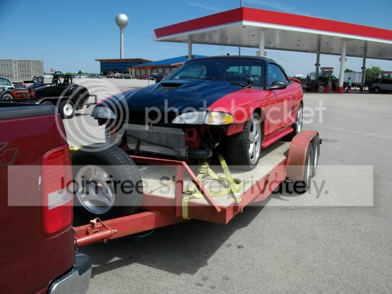

here's some pics and a vid of when he was starting to tune it.
