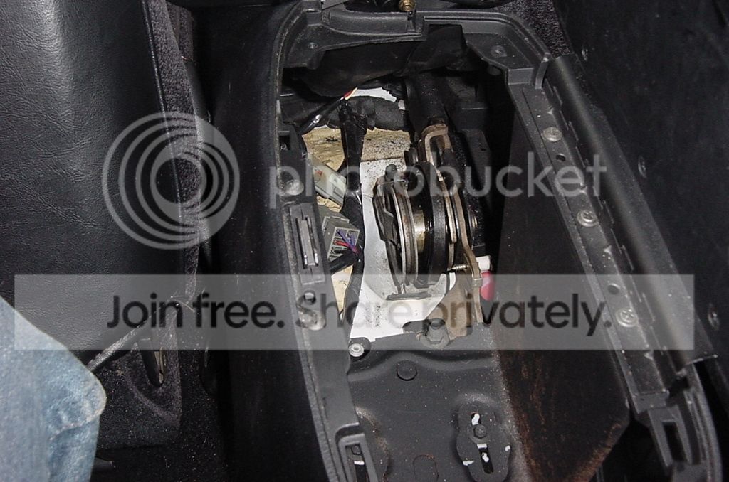

I started with the inside of the car - The fog light switch.
I took the screws out of the storage compartment in the
console and removed the compartment. "You don't need to remove the lid" This allowed me to reach up under the console and find the tabs for the coin holder that's on the console and "pop" it out
Next I had to find the plug in for the foglight switch it's fastened down next
to the wire for the convertible top. (if your cars not a convertible)
I had a console already out so I took a picture of it to show you what
I mean
It takes a little messing around to get the plug off it's holder
But after I got it loose I ran it out through the hole from the coin holder and plugged in the foglight switch. When I put the headlights on low beam and turn on the switch the little yellow light on the switch came on. TA DAAAAA It started to get dark and I stopped

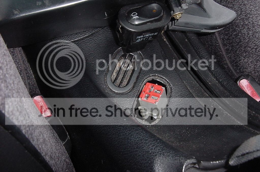

This is what I was talking about when I said to remove the console storage compartment.
It takes a few minutes to find and unhook the wires but it's still better than removing the console
When I found the wire I was looking for I ran it out the hole where the coin holder was and
plugged in the fog light switch. With the lights on low beam the light on the switch came on.

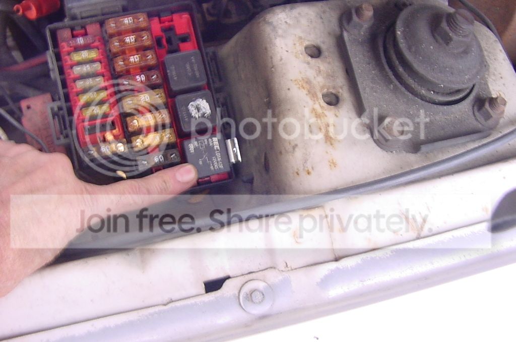

Next I went to the fuse box under the hood the fog light switch on I put a relay in where
the owners manual said it should go. I felt it "Click" when I stuck it in so I knew juice was going somewhere

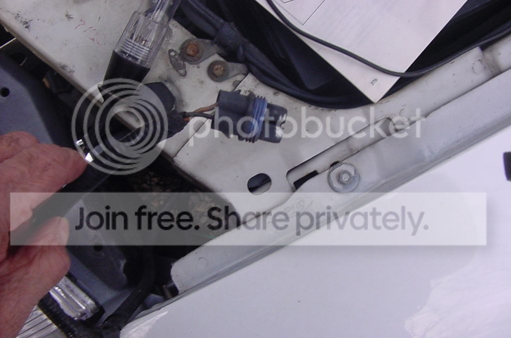

Next I went looking for the foglight wire it was easy to find it right about where you would think it should be. I checked it and it has 12 volt when the switch is on.
I pulled them up from down below so you could see what they look like. It looks like the plugs
for the fog lights are already there and ready to go.
