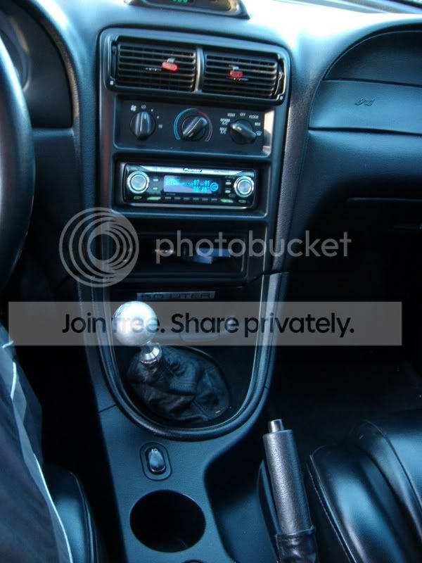

after having done this swap myself, i would strongly advise you to replace pieces that are frequently handled (steering wheel, door bezels, latches, etc) with OEM black pieces. it may take a while to find them, but not having to constantly re-touch them (which you will) will be worth it. here are some pics from my swap (also had the black/tan combo.. hated it):
i used Duplicolor Interior & Vinyl spray for the stuff i painted, new carpet from 50resto, got the seats from a buddy, got a rear-seat-delete in black carpet, and replaced the pieces i described above w/ OEM black pieces from junkyards and ebay. definitely a worth-while mod, imho.

The dash was really pretty easy to dye i had everything pulled out of my car because i was putting in new carpet. I used the Dupli color vinyl and carpet dye on the dash and i used Fuzion platic paint on the platic stuff like the console, i need to finish up a few pieces hopefully this weekend. I will post some pics i have a ton from different stages of the process. I will say though the carpet swat was a pain in the ass to get it in there its not as molded as they say it is.

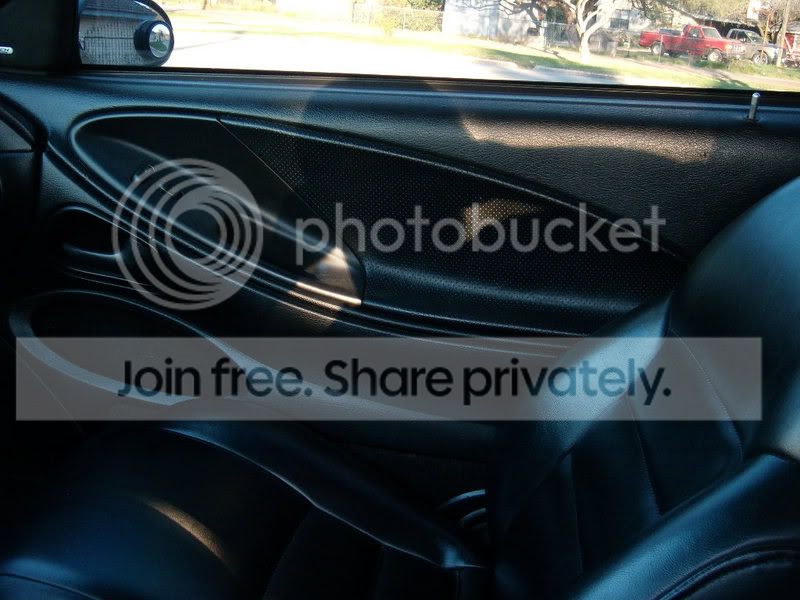

YEah i didnt take out he dash. Its not hard just do some masking. I finally did the door panels today, i will probably just buy some but i just did this for the mean time.

I need to redo the kick panels with a different spray i used the vinyl dye on them and it doesnt stick to well to the platic.
