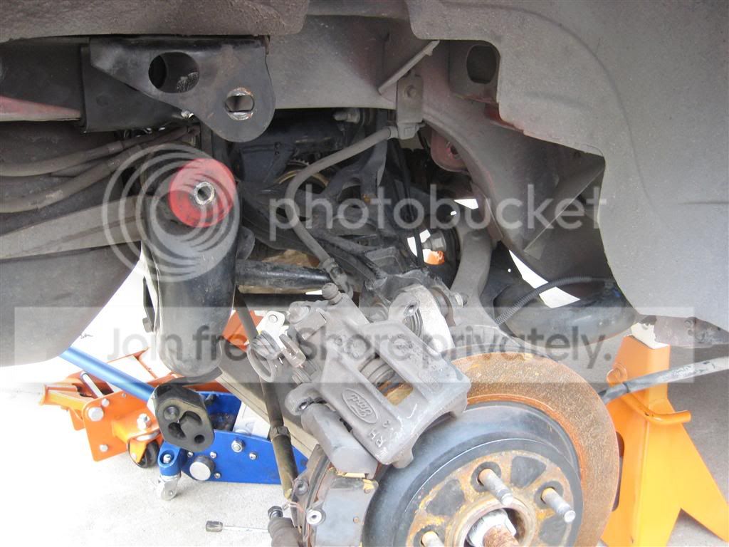

Other than that, it's just bolt in bolt out, make sure you got the ABS brake sensor wires and the brake hoses, you'll need to adapt your hard lines to mate to the brake hoses but it shouldn't be a big deal, just bend them around a socket a few times to take up the extra length until you can bolt them in, make sure they won't get pinched by anything in the IRS as it moves.
I did my swap in about 4 hours, on jackstands, in my driveway, by myself...I do have air tools.

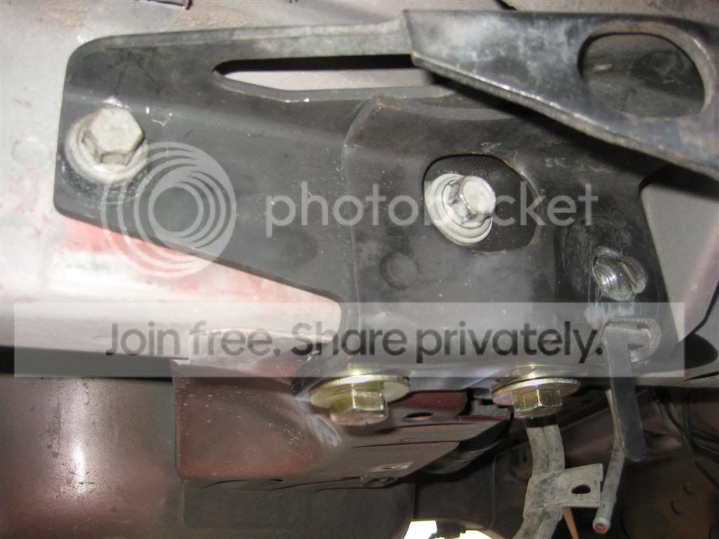

2 holes need to be drilled on each side to mount the cradle securely.
mount the brackets with the old quad shock bolt locations, then drill up through the trunk and get some grade 8 bolts, nuts, and wide washers. Start with a smaller pilot hole to make it easier...

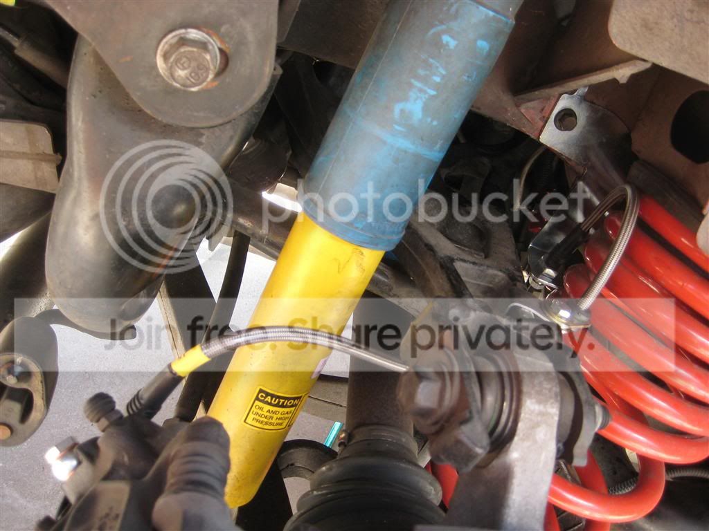

brake line mods on a `97, your T will be in the center rather than on the passenger side, the idea is the same you'll just need different length lines.
cradle bolts, the ones going straight up had to be drilled, I dropped my gas tank to give me room for my large drill, so I replaced the fuel filter, fuel pump, and fuel filler tube gasket on the side of the tank while I was at it.

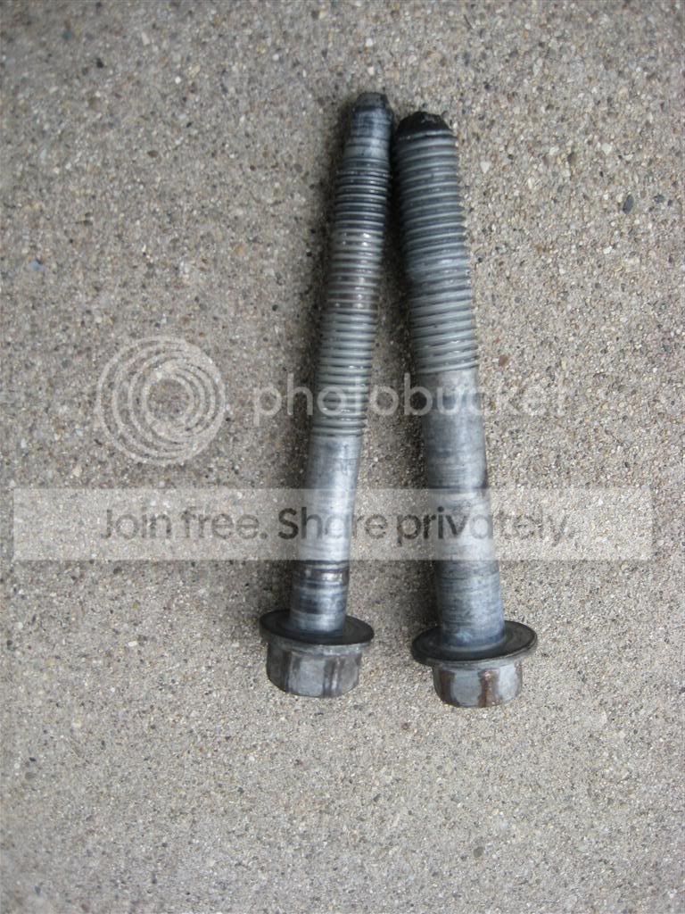

I had to drill out the chassis of my car where the front of the IRS bolts to, in order to use the larger 14mm bolts that are recommend to reduce the 'cobra clunk' while shifting, as the smaller bolts can let the front of the IRS unit move slightly.
(stock SRA bolt on left, larger IRS specific front bolt on right)
