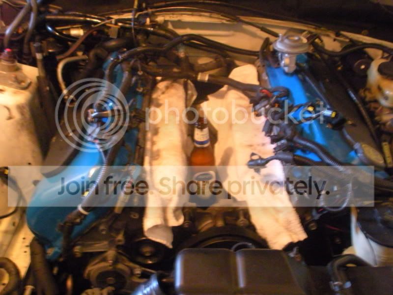

Getting Ready! I work overnight's so it's always tough to work on my car, so in an effort to get thing's moving I went ahead and removed the stock upper and lower intake, the irmc's and the controller, the fuel rail, and stock injector's... Almost everything came off pretty easy, the only casualty was that one of my composite intake gaskets broke as I was wiping it down! but what is to be expected it was original! and 15 years old! Then it was onto the coolant crossover pipe, man, what a pain in the balls that was to remove :BangHead: I literally had to get a ladder and climb into the engine bay which is not an easy feat since I weigh 250 :confused1:

Good luck with getting the crossover tube back IN too, it's a Major PITA. I did one in school and I had to use LOTS of vaseline/wiggling/strength to get it back in. Can't wait to see end results!

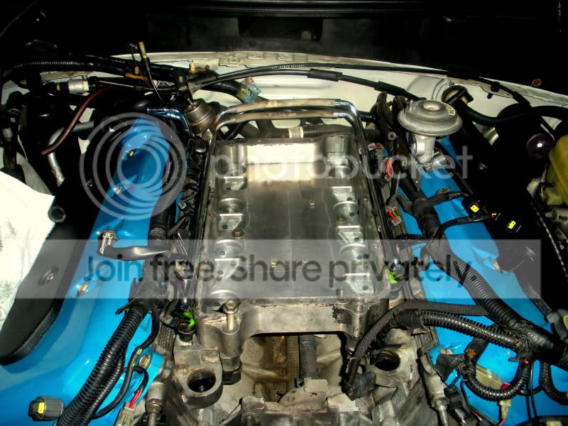

I got home from work at about midnight and since I already tore down the car it's just a matter of installing the charger and getting everything hooked back up!
1st up was the the open house lower manifold.
Once that was installed it was time to put the 42lb inj. and the fuel rail back on.

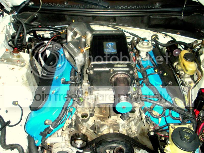

With everything buttoned up! I decided to test fit the charger.
It's 1:50 a.m. and I am spent! been up since 7a.m. worked 3pm-11:30pm and worked on the car until 5 minutes ago! finishing it
up sometime this weekend... more pics to come :wink:
