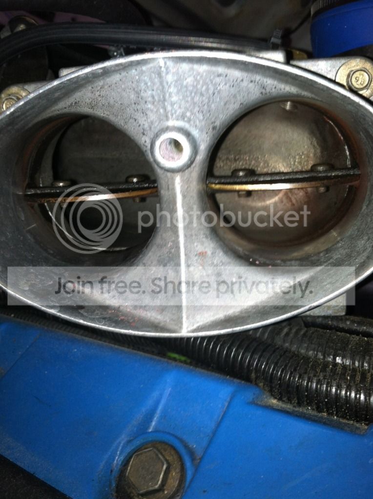

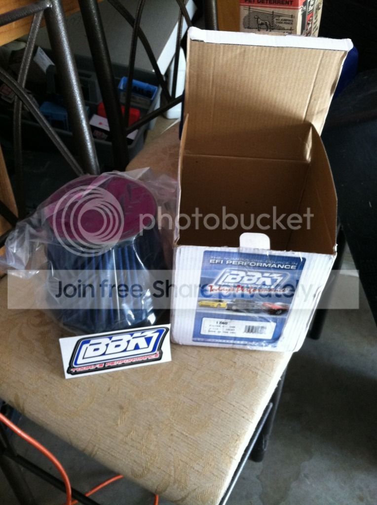

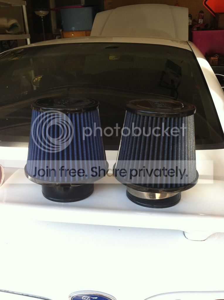

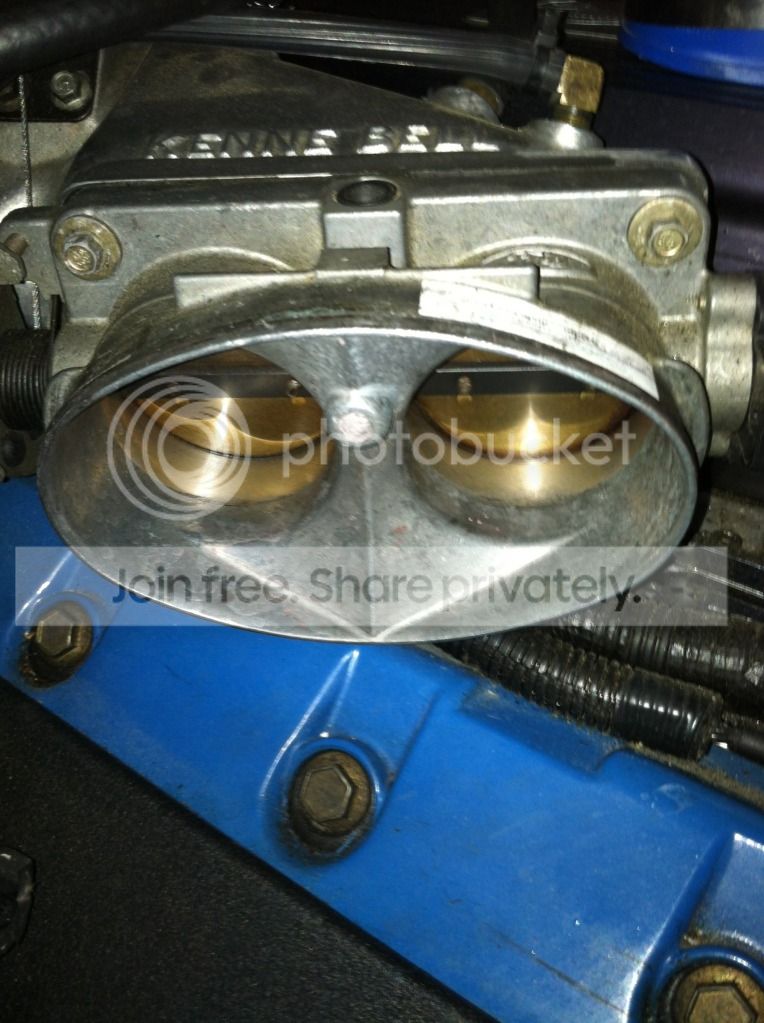

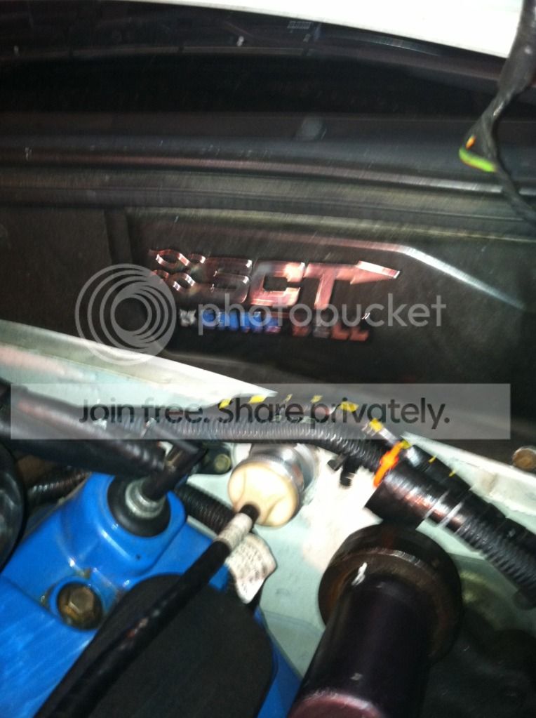

Well today I replaced my air filter, just out of routine maintenance. Several days ago I ordered a replacement BBK filter from American Muscle. Old filter was pretty dirty, but not too bad. Also included pics of my throttle body. Back when I first got the car some guy told me that my meth would corrode my tb, but my tb looks very clean to me.

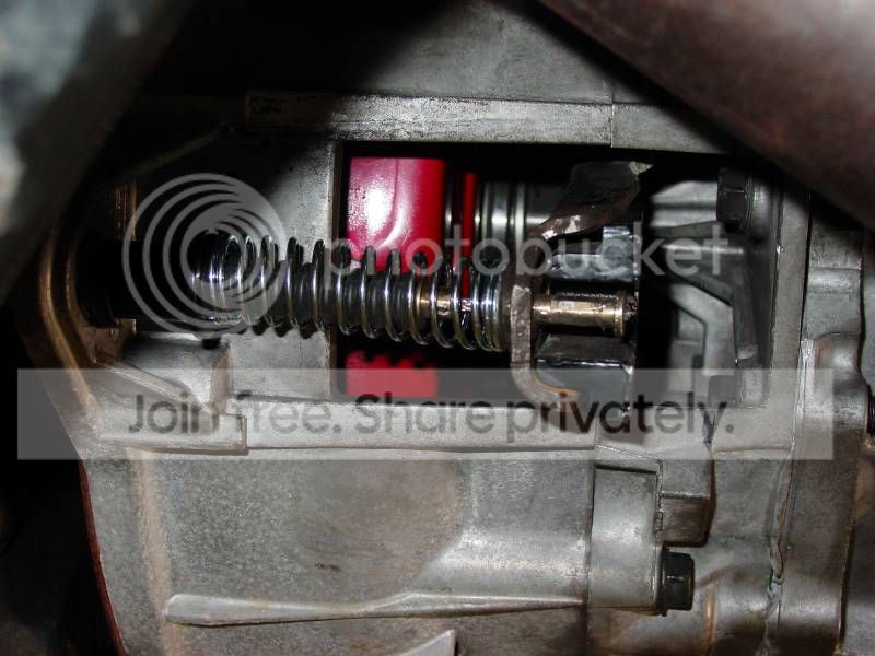

Ok, so after some driving, tweaking, and googling I HOPE I have found the solution to my rattly clutch pedal. Some people call it the clutch freeplay mod. It basically allows you to take up the slack in the clutch cable that is often the result of having a aftermarket clutch, plus aftermarket firewall adjuster/quadrant by putting a spring between the clutch fork and the inspection hole wall to push the tob off of the clutch fingers and also reduce excess slack in the cable. Since I installed new firewall adjuster and quadrant with my tranny install, I think this resulted in excess slack in my clutch cable.
I ordered the spring, and should have it in 3-7 business days, so hopefully that solves my issues.

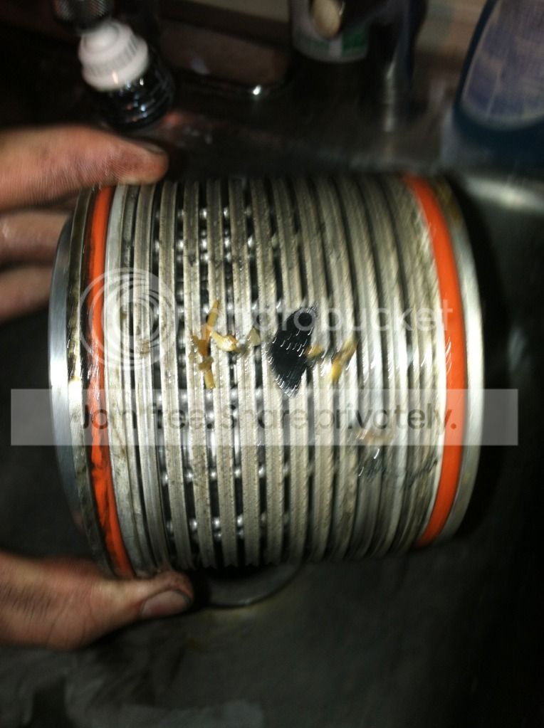

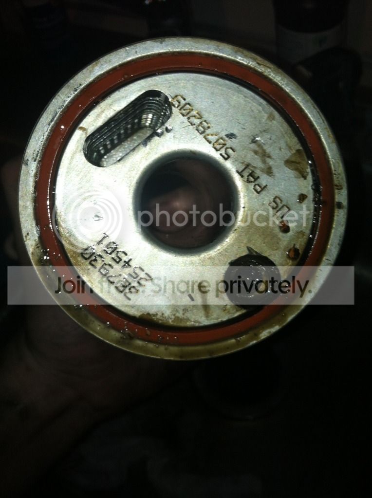

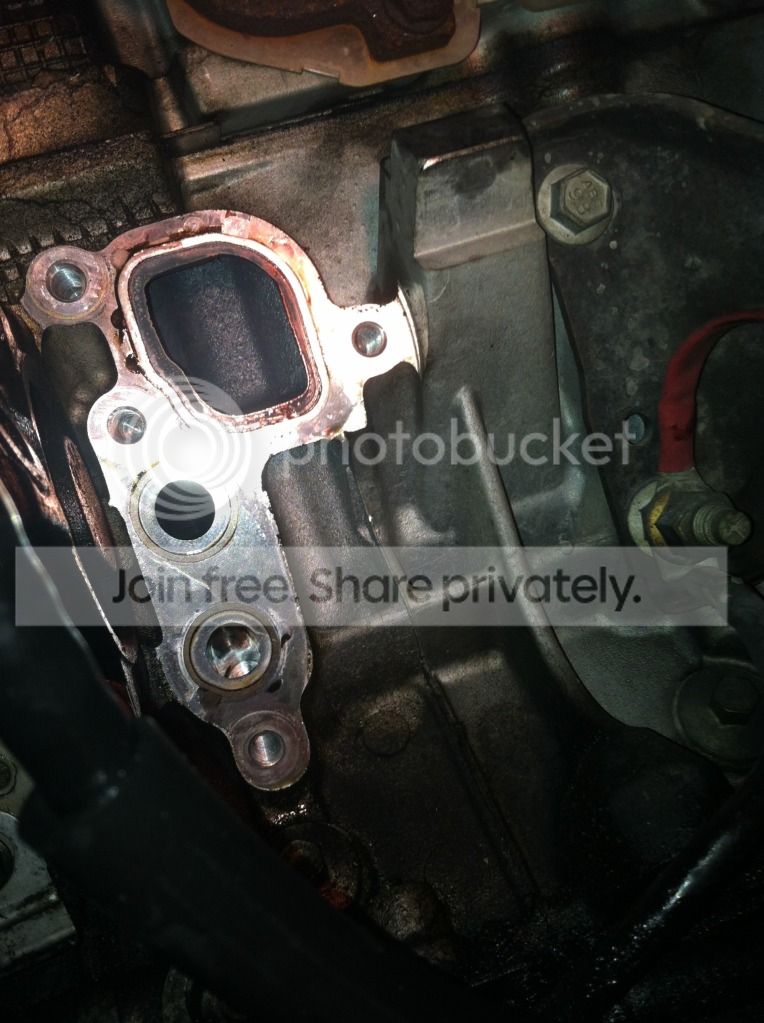

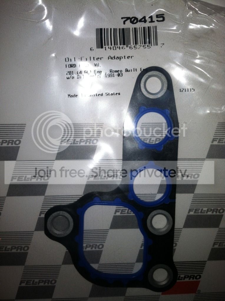

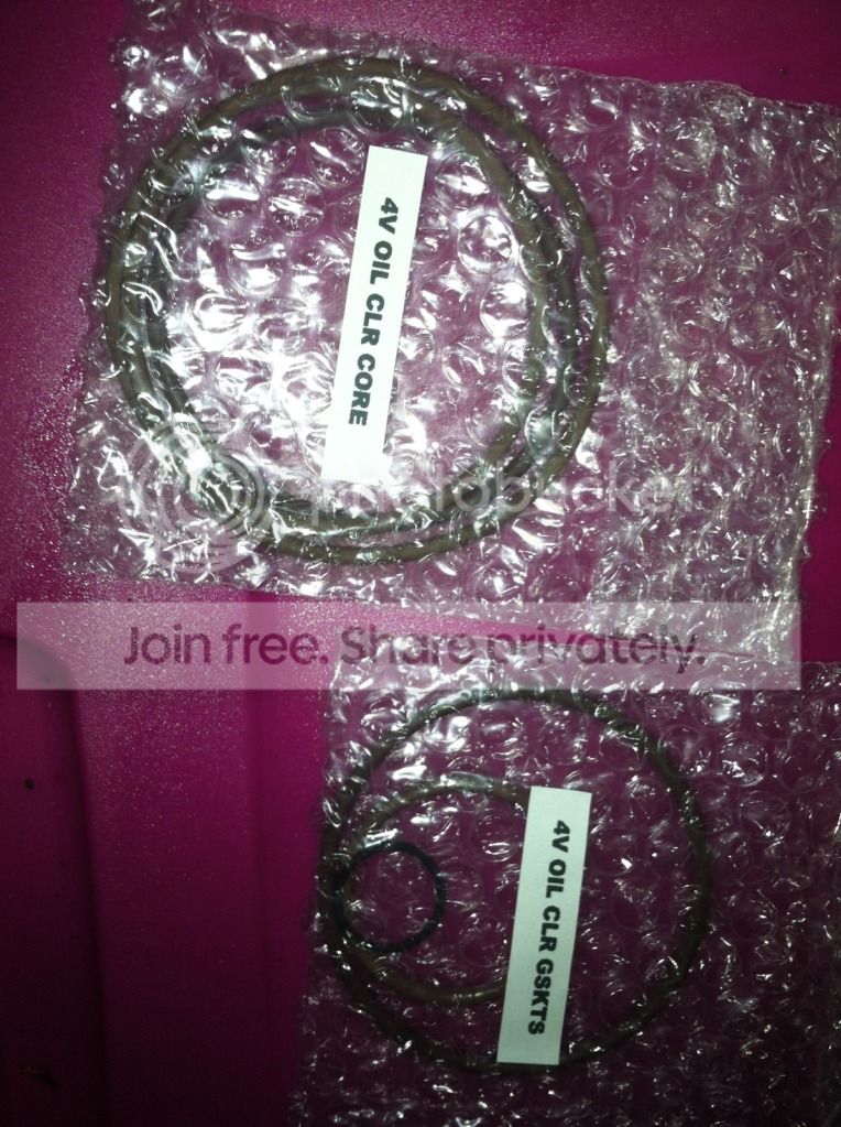

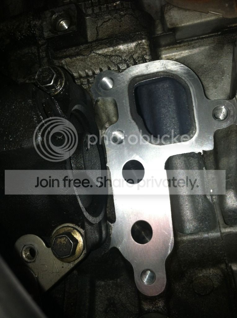

Then I was hit with more bad news, my car developed a massive coolant leak. Upon further inspection I found that I had a leak between the oil cooler adapter and the engine block. I ordered the gasket set from here-http://www.speedconcepts.net/product_info.php?products_id=967great deal, only $45.99. I followed this guide to replace, its fairly straight forward.http://www.svtperformance.com/forums/how-230/772115-how-repair-leaking-oil-cooler.html I also replaced the oil cooler's internal seals at this time, they are included in the above kit. I took a few pictures while I did mine, but honestly the link I provided does a better job of explaining the process.
Seals the kit comes with.
After I got the oil cooler off and block adapter out I cleaned the block surface with sandpaper.
My oil cooler had lots of crap in it?
Cleaned everything back up and installed new gaskets. Good as new now. For anyone with a 4v, fill the coolant up from the coolant crossover tube so you have no air bubbles in the coolant system and you won't have to burp it.

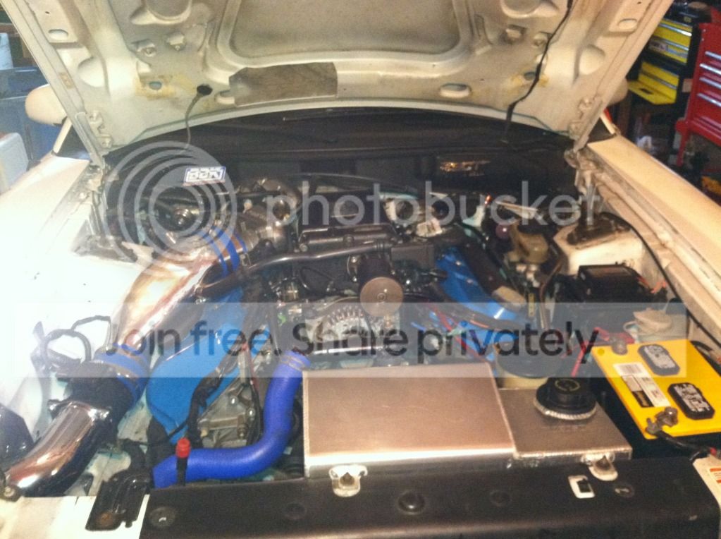

Also Ive been trying to figure out what I want to do with the exterior of the car. Ever since my transmission went down, Ive been wanting to draw attention to how much is actually done to the car. There is very little that hasn't been upgraded in some way. However the car's paint is really bad. Some areas are fine, mostly the roof, hood, and parts of the sides, but the bumper covers, sideskirts, and portions of the quarter panels nad fenders are literally flaking off! Its been that way since I got it, but my paint budget was spent on drivetrain/trans.
Since I can't afford paint, Ive gone a bit "ricer" with some vinyls. If my paint was decent, I would never do this, but since my car cannot pull off the "clean" look, I'm going for "track car" look. I also have a few more exterior ideas that I am working on, but I'm keeping them to myself until fruition.
I am proud to showcase some of the companies that Ive had positive dealings with. Also take note of my fat dog and my sweet wooden car ramps I made! Also visible are my import side mirrors, which I just discovered fold flat.
Kenne Bell sent me all these for FREE.
I'd like to find a more decorative battery cover, I'm not thrilled with my yellow battery under the hood.

Yeah I was surprised all the crap in the oil cooler, especially because Ive done 2 coolant flushes on the car in the last year lol.
From what I could see the cooler traps debris so I guess a flush isn't enough to clean out the cooler, idk?

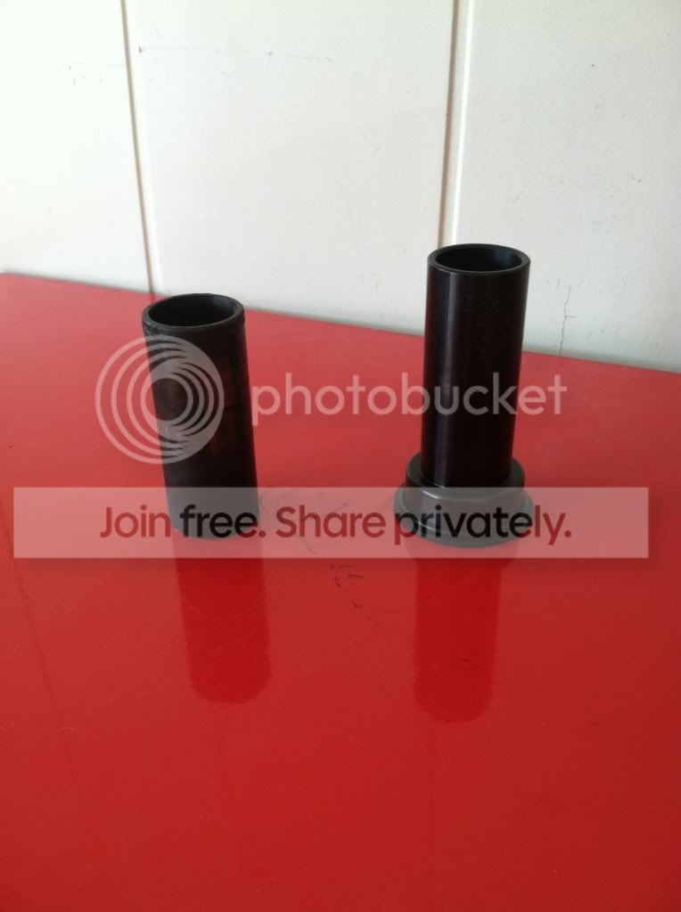

I'd determined that my clutch fork rattle/death shake was likely due to a broken throwout bearing retainer sleeve. Today I finally got around to pulling the t45 out of the car to verify and replace the bad tob retainer sleeve.

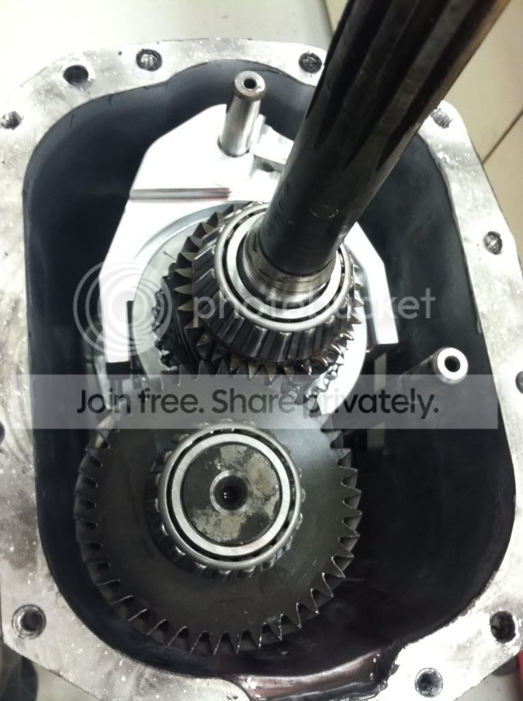

I dropped the trans and found this.
Broken retainer sleeve on the left, new one that will be replacing it on the right. The base has snapped off.
Tomorrow morning I'm taking the trans to a Ford Specialist to have the new retainer sleeve installed and then its just a matter of throwing the transmission back in the car asap. Hope to have it back together by mid-week, but it will depend on the weather, my garage isn't heated.

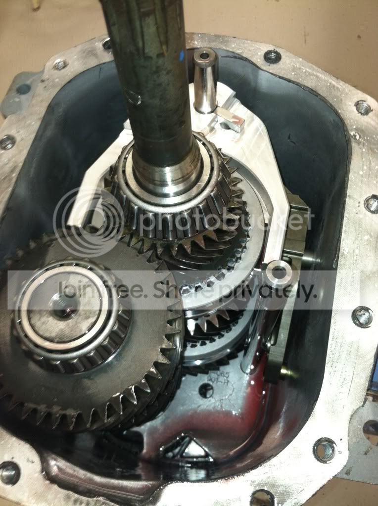

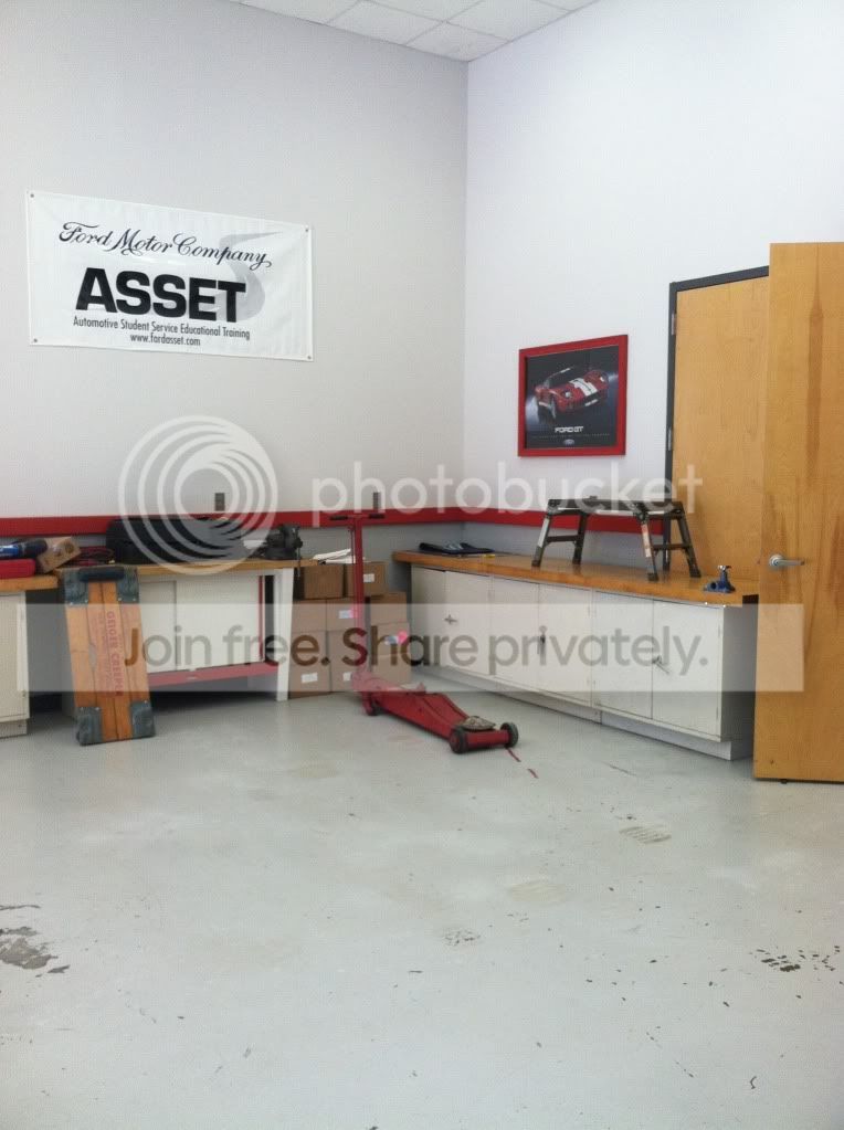

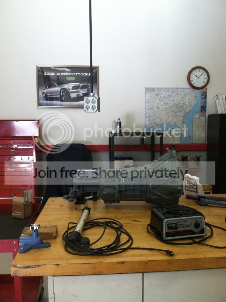

This morning I met with a Ford Specialty Technician(not sure if this is the proper term) but a very high-ranking, knowledgeable guy. He helped me remove my t45 bellhousing, press out the broken throwout bearing retainer sleeve, and reinstall with the new one. He has access to the Ford training center, so we had very nice facilities at our disposal. Only snapped a few pics, but the training center was pretty impressive!
You can see the billet "slammer" 3/4 shift fork.
Gonna start with the transmission installation this afternoon and depending on progress be driving the cobra by tomorrow.

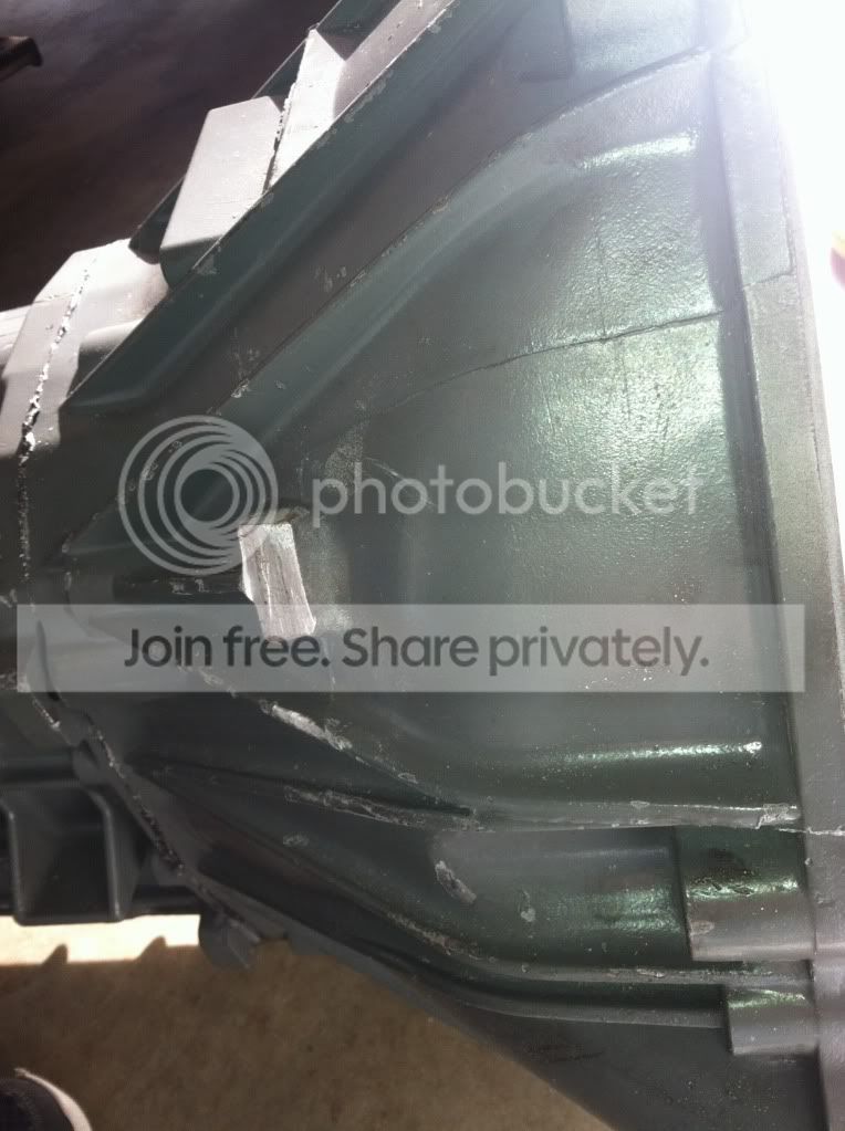

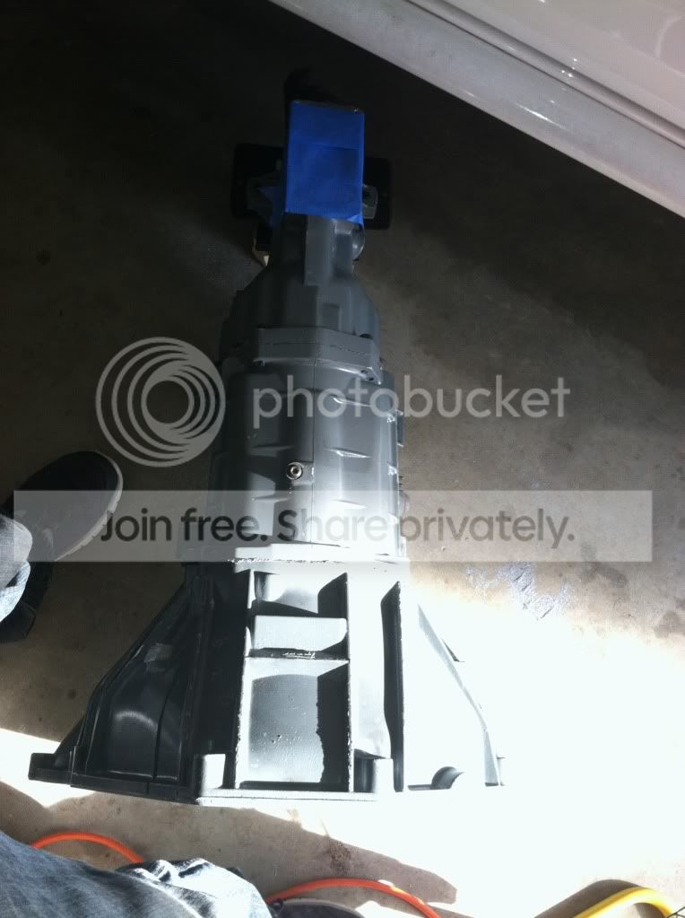

Before I put it back in, I cut off these portions of the transmission to free up additional clearance between the case and the transmission tunnel. Made it a hell of a lot easier to install/uninstall! Wish I would have done this the first time I pulled it out!
I used a sawzall to cut these two casting "ears" off the case.
Made sure to tape off the shifter opening to ensure no metal shavings got in the case.
I then filed down the rough edges so I wouldn't cut my hands while installing the bellhousing bolts.
This made a significant increase in clearance between the t45 and the transmission tunnel!!!
Also I think I made a few ounces of weight reduction haha.
Another tip I found: It is easier to "benchpress" the tranny back in, as opposed to how I've previously done it by using a jack to position the t45 into position.
