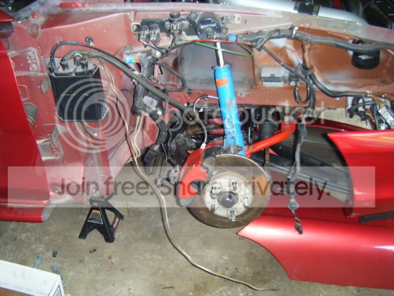

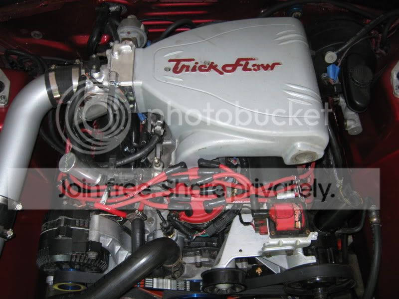

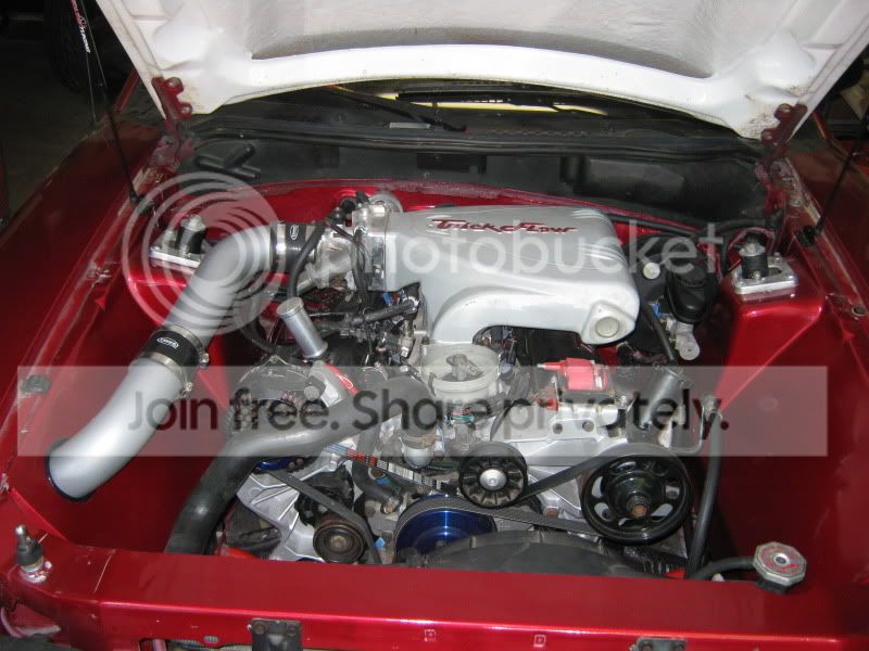

today:
buster
Jul 3, 2009
those pulleys would look nice if they were anodized red, to match the paint and the the red trick flows....just IMO
buster
Jul 3, 2009
they look nice, but yeah i klnow the feeling opf just wating it to run, its gonna be a beast when it does tho

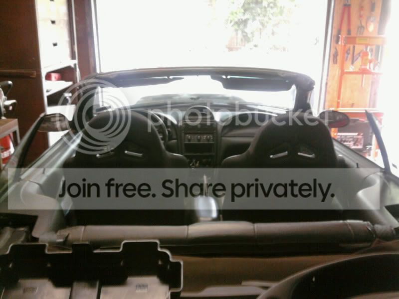

Different seats:

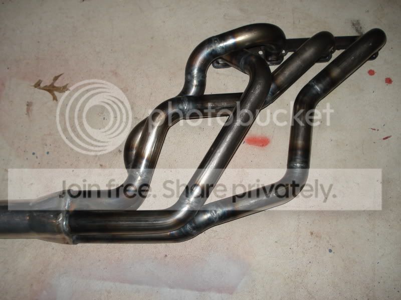

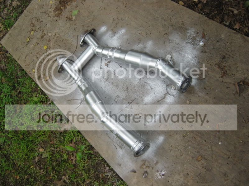

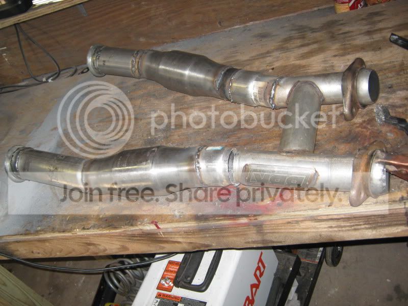

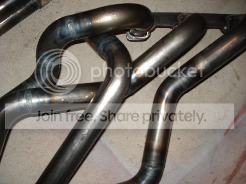

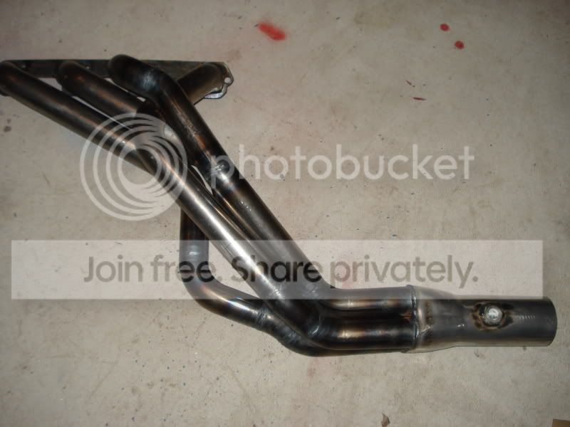

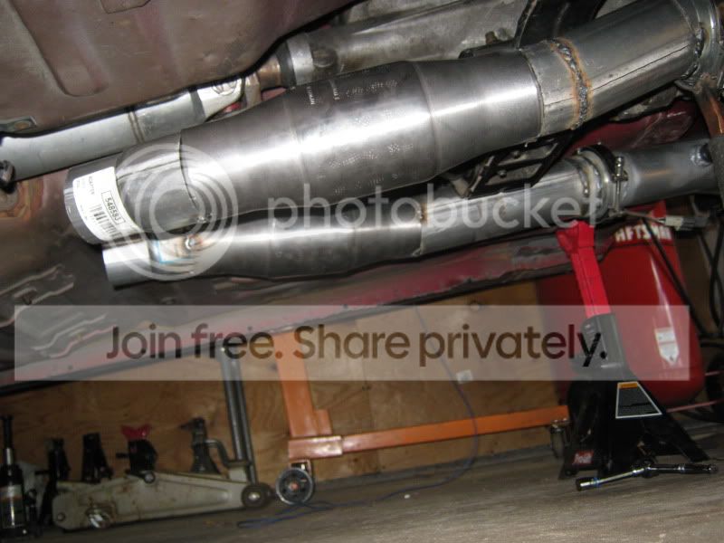

Custom Exhaust:
tacked together
final big pass with welder to prevent leaks and paint.

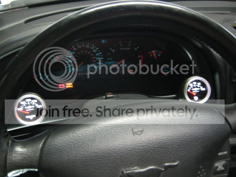

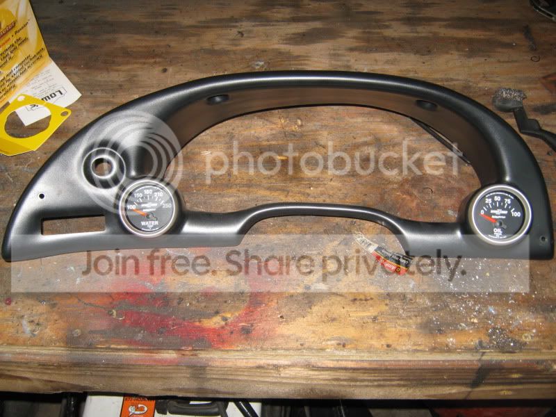

Gauges:
Sending units

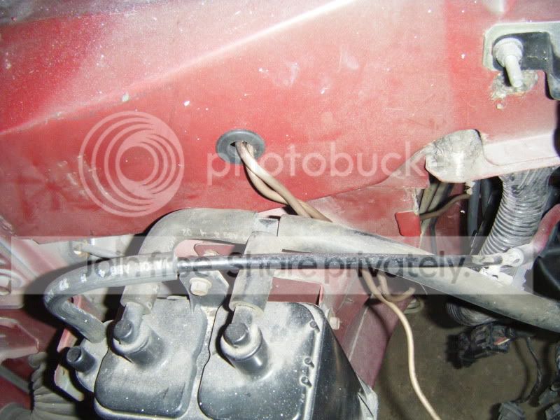

Cut wires to fit
Wired up:

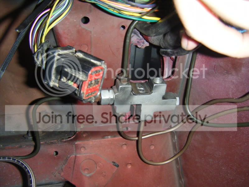

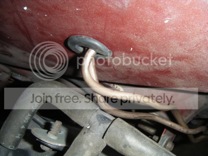

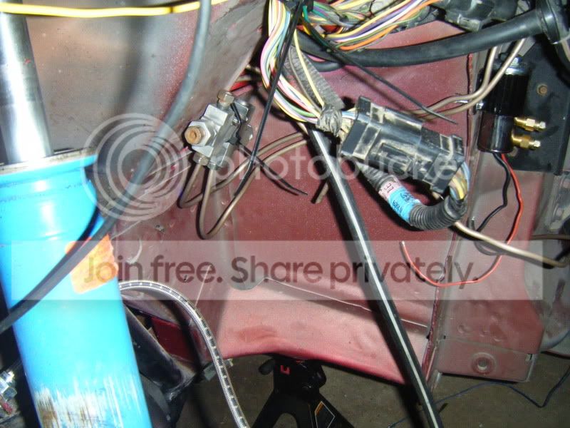

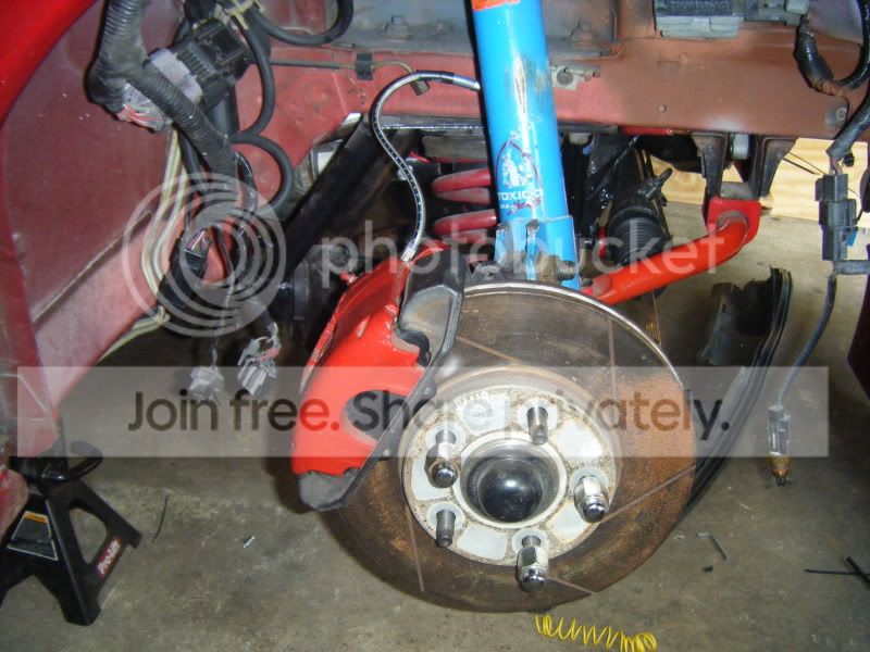

Currently running brake lines and line lock

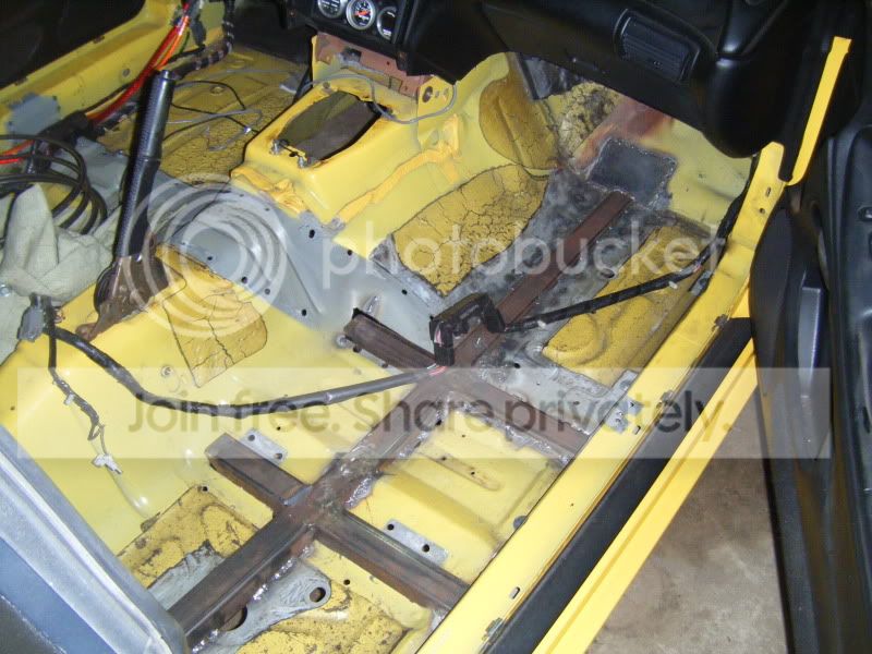

Thanks man! Im hoping to get it on the road soon and driving around to tweak it a bit. I still need to work on the tune and install the wideband. After i get that all strait i have a new top to put on, going to do custom through the floor subframes and tie it all together with a cage. I also still need to build the rear. Besides that everything on the car is pretty much new. Ill paint it eventually. Just more concerned with it running right now.

Lines:

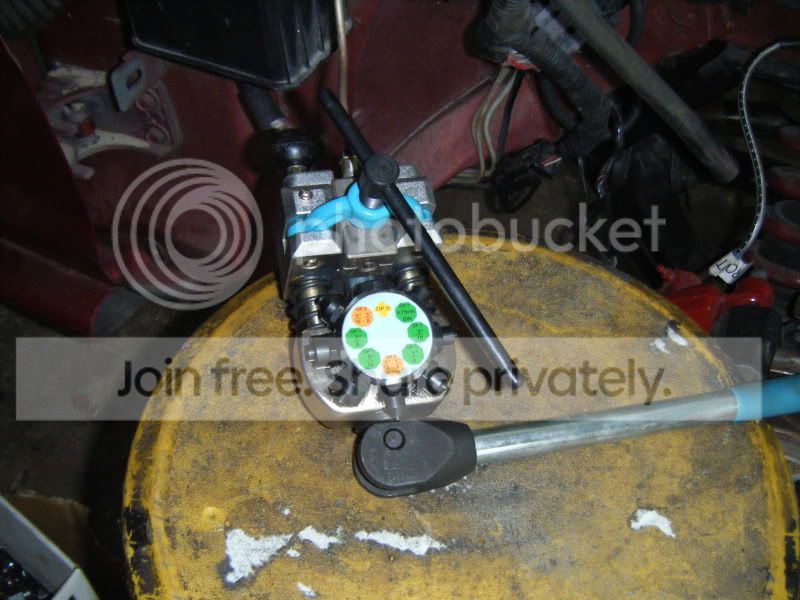

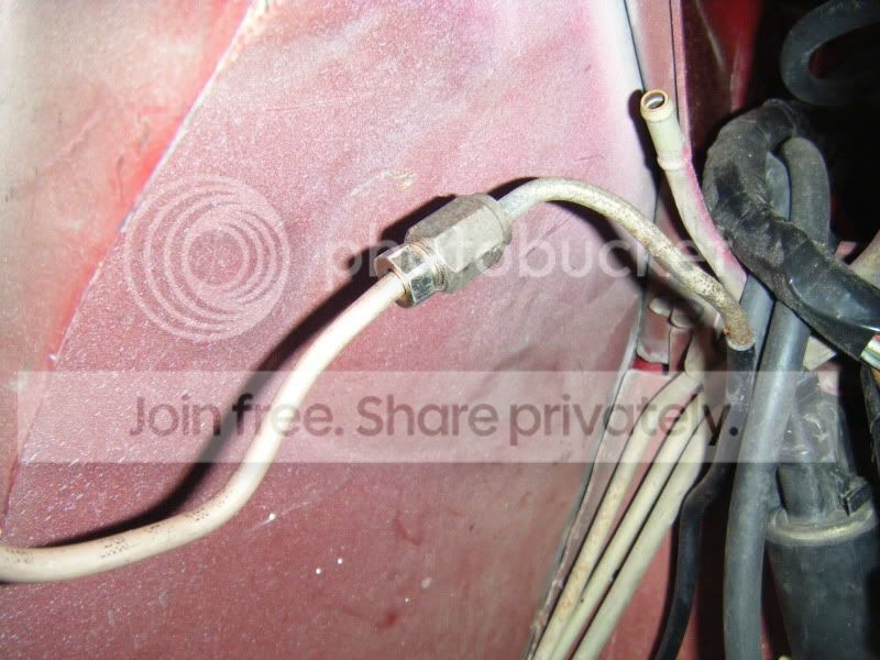

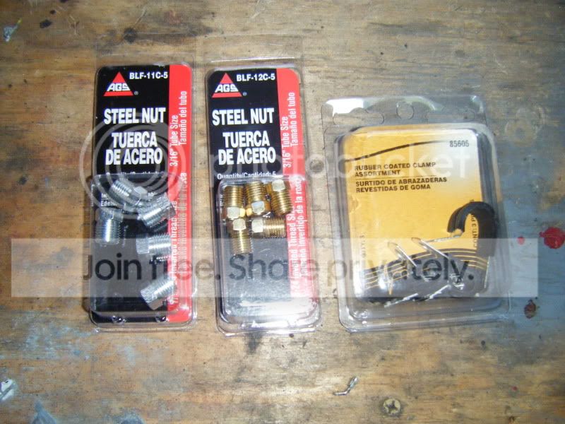

Day got cut a little short. One of the line lock 1/8'' NPT to 3/8'' x 24 adatpers stripped out and i had to leave and try to find one local (finally did $2.50 each)I want to get the brake stuff finished and bled this week so we can start trying to drive the car around the block and work out the little kinks and tune.

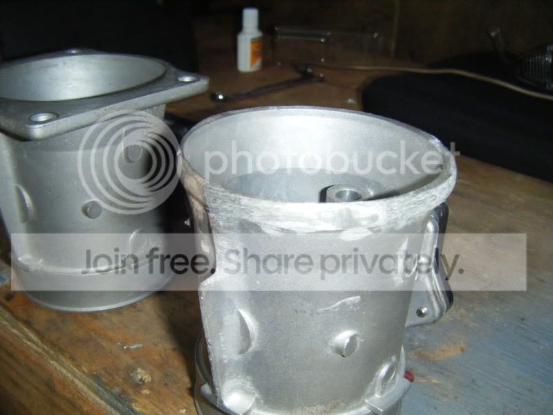

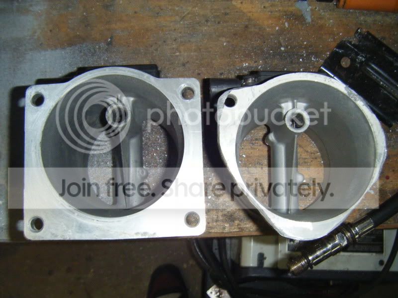

I also started grinding down the flange on the maf so i can go strait to a K&N and save space.

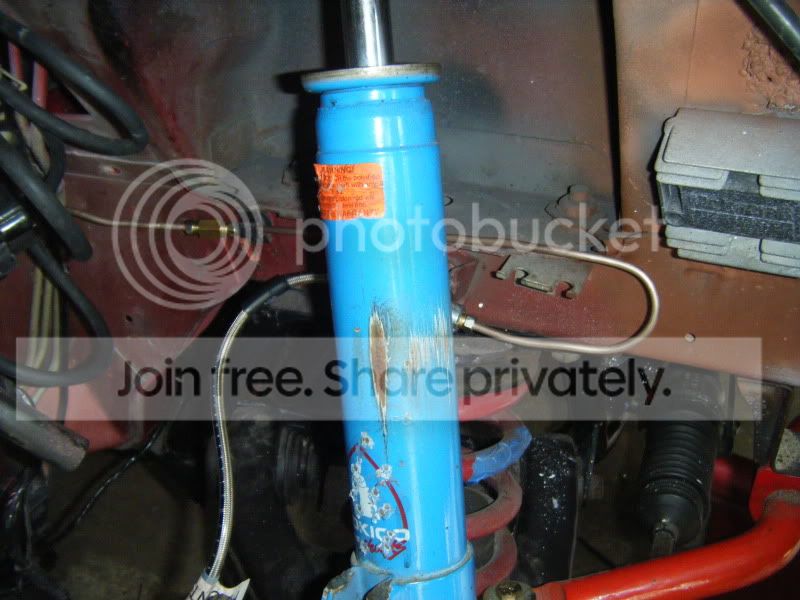

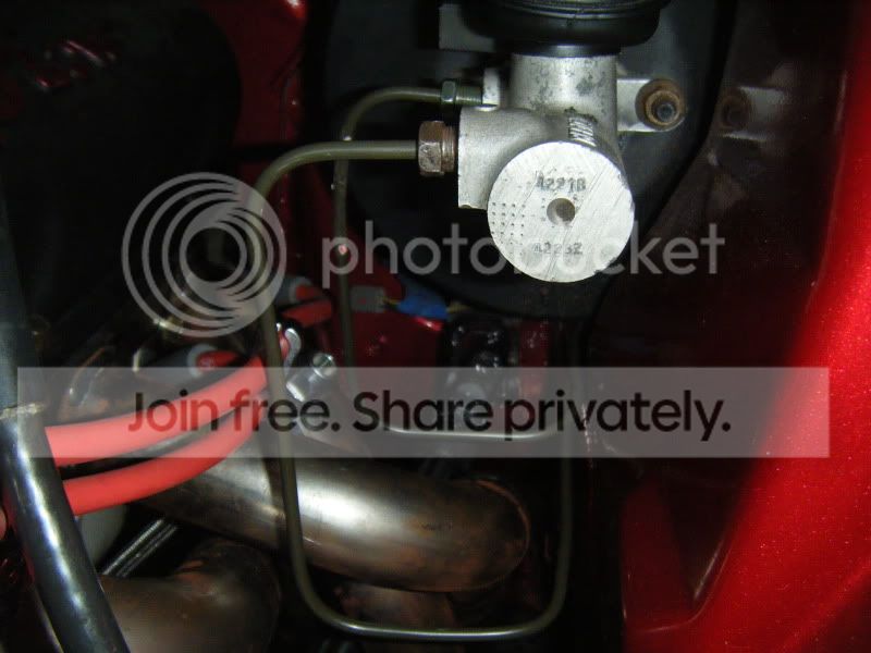

This line looked a little kinked:

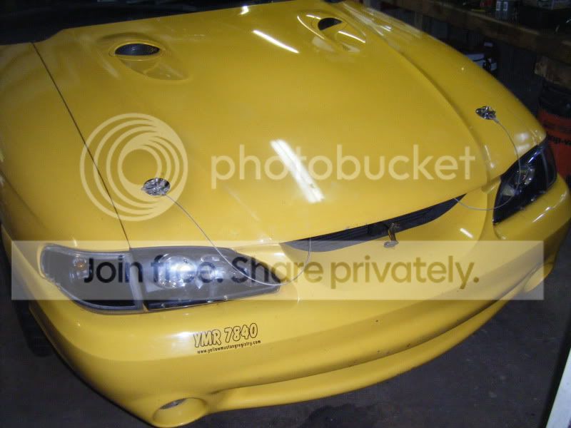

Chipped the hood:

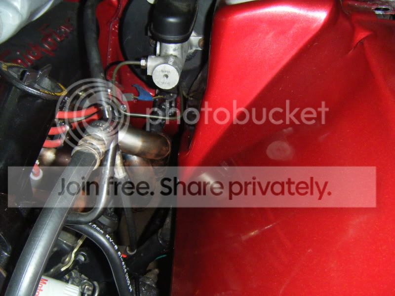

Ran lines i thought they were too close to the header so i ran again:
