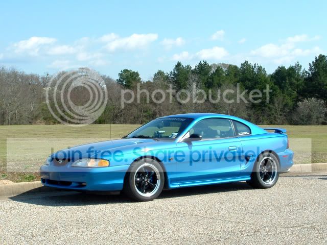

Jessica is on here, i believe her username is Toxic5.4, ill double check tho, i havent seen her on here in quite awhile

That looks bad ass.
I cut the hole in the stocker... no need in ruining a cowl hood.
