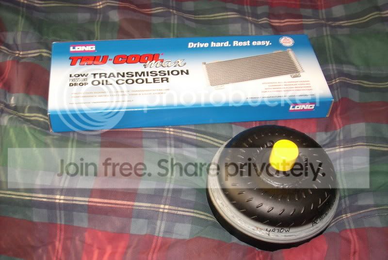

Hey fellas. Haven't been on in a while because Ive been really busy with school and all, and of course because the tranny is shot. Well lately ive been trying to really finish her up. I recently just recieved a pretty huge tranny cooler and my BC-Auto 3600 lock up billet converter. The transmission should be finished up within the next month or two and I am also throwing in some blower cams and going to keep it as is for a while. Heres my new goodies!:

Nice man. Good to see you back. Love your car and seein the sig, hah. Good luck with the rebuild. What are you expecting with the new cams.. 400+ right??

thanks a lot man. well yeah through stock non pi heads and my stock auto i put down 390 something and 400+ tq. This was with stock PI cams. My tuner said upgrading to a custom grind blower cams I should see 420rwhp+...possibly less now with this converter

haha thanks man, I'll keep everyone updated! It is going to feel like a rocket after driving my 94 explorer for the past 8 months lol
