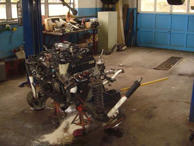

Drop the engine with the K, seperate on the ground, Install LT's K back on, Eng & Trans back in car, down the road you go with freed up HP's

Car sat over night... 10:00 am
Noon

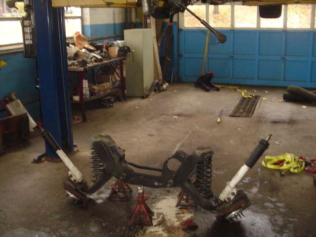

and then about 4 ish after getting the engine/trans off the drivetrain table and on to either the ground (trans) and Engine stand

MustangChris said:
ballar pics duffy...
and im surpised your front end doesnt sit higher up with the motor out... :p
after the motor was out I attemped to put the k back in the car, Fail,the springs wouldnt compress enough to get the struts back in sooo, i took the struts out :)
