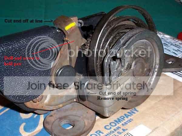

Steve-Oh
Mar 26, 2006
5,887
288
39°57′9"N 75°9'48"W
I've never done it, but I bet it could be a pain if you have to pull the cables tight to attach them to the spring. Not sure though.
If I remember correctly the is a "ratcheting" type mechanism that i believe helps tightened the cable.
You can sort of see it in this picture but its where the red Line points to and you can adjust the position of that to accommodate cable stretching and tension
