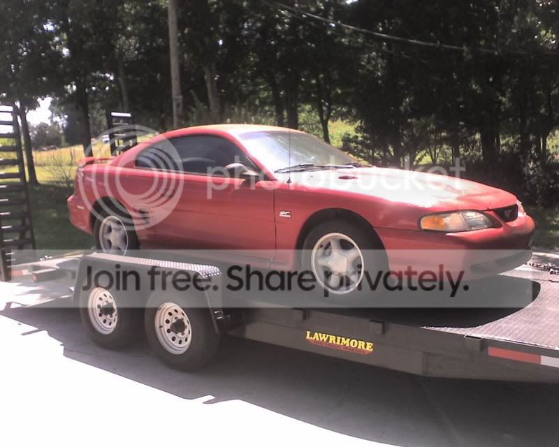

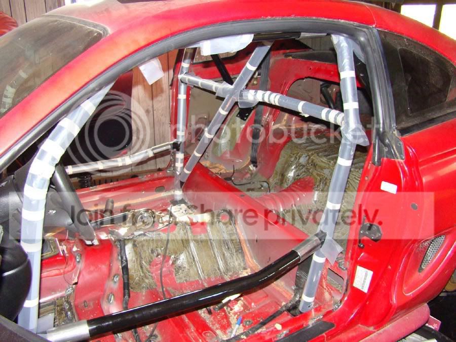

F it. Im going with either a CHP street fighter alternator bracket or a March alt bracket.
The car is under construction now and trying to finish it for the spring.
I want to start off light but in a few years move into CMC or American Sadan

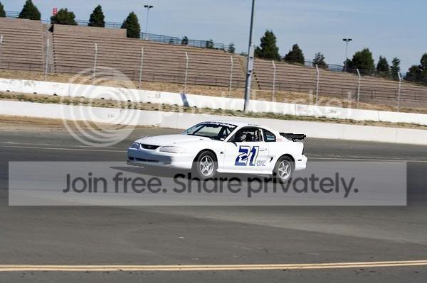

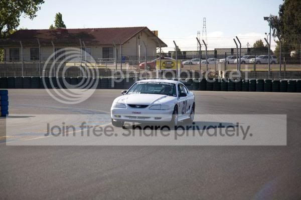

Yes- Paul +1, in fact you HAVE TO run power steering in cmc/cmc2 Same with power brakes. If you take the leap to American Iron X you can do whatever. Also, you will not be eligable for points in CMC if you do not have the factory setup for brackets/ power steering. Not trying to bring you down, just warning you. Ive been running CMC/CMC2 for over 5 yrs. Let me know if you need any help with setting the car up. I have a nice setup that has won us many races on the west coast. :)
