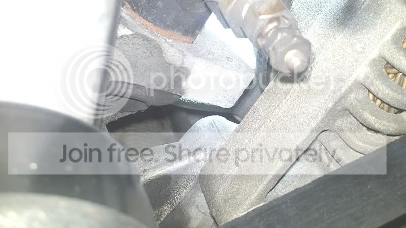

You must be quoting Sean Hyland's book, which is best used as a coaster or might be better used for you to roll up and shove it up your hindquarters. Since you know so much about modular blocks, do you know the easiest way to distinguish a WAP block and a teksid is? Well if you did, you would know the teksid has square grids in the intake valley while the WAP block has diamond shaped grids.. Now do me a favor since I would have to get off my high horse to see, but what type of grids do you see in this picture?
