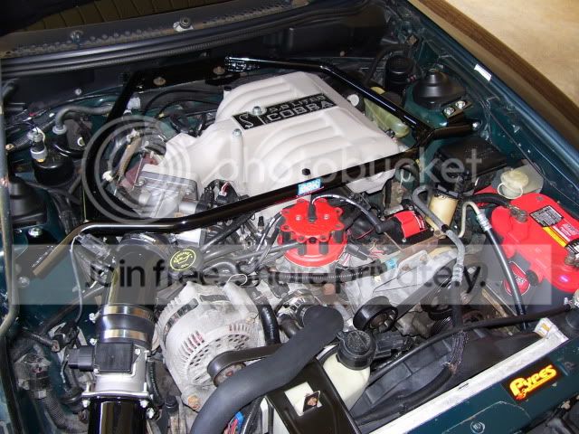

One question that slipped my mind is Will this intake fit under the stock strut tower brace ????
DFG_magic
Nov 29, 2007
2,064
Kennesaw, GA
No it will not. You'll need the BBK Gripp 2513 brace if you want to run one. Here's a pic of it on my car:

Maximum motorsports strut tower brace will also work and it is much stronger than bbk thicker tubing and larger gauge, they advertise 15% less flex in the front end after you install it. Thats what i got. :thumbsup:
