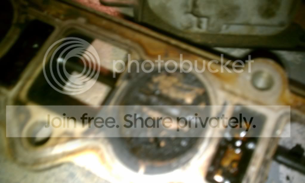

got the plates out and saw instantly why there was a power drop... they were disgusting. absolutely terrible. the driver's side plate was fucked up. the bracket that holds the cable was bent badly, the cable was kinked and not even connected to the IMRC plate. even if the cable was connected, the butterfly valves were so stuck, it wouldnt have made a difference.
the passenger side wasnt as bad, dirty, but still functional.
since the driver side was so bad, i decided to just delete them.
this is after breaking up most of the Carbon deposits that were caked onto the plates...

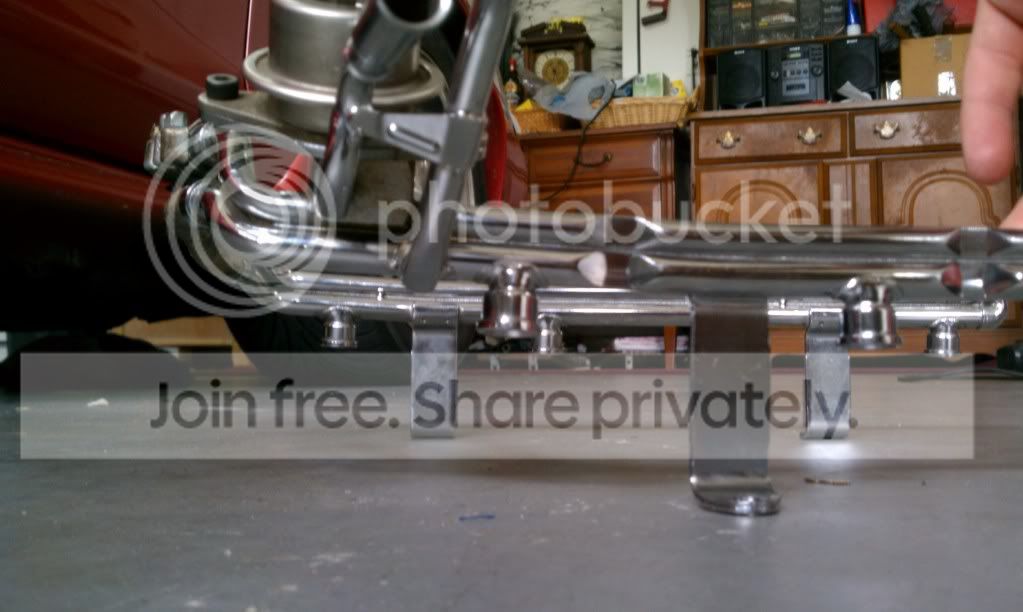

bolted everything together, started her up, and Vacuum leak! furthest back fuel injector on the passenger side would not seat in the IMRC plate. Fuel rail bent somehow during dis-assembly. :mad:
got the rail repaired and went to install. started up great, great idle. man was i happy, until my alternator stopped working. found out a wire was cut when reinstalling the coolant crossover. repaired the wire and what do ya know? it holds voltage again!
