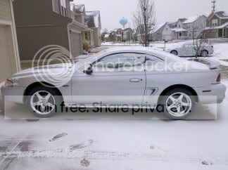

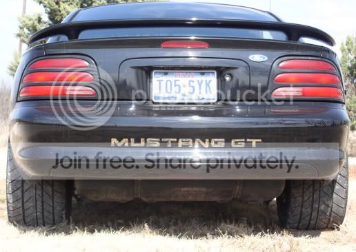

Yeah you can either flip the quad shocks or remove them. This is my car with 17x10.5 w/ 315/35/17's out back. Zero rubbing. I have Eibach Sportline lowering springs w/ ISO's, no quad shocks (aftermarked LCA's), and 3 inch exhaust tips.
