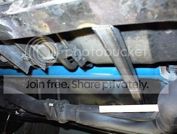

I decided a few weeks ago to take on the project of making some "Subframe Connectors" for my stang.. After reading thread after thread of people saying how well they helped the stangs out i decided to see if it was really true..

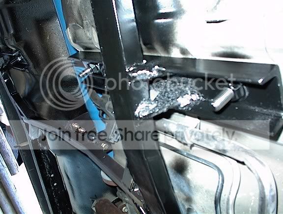

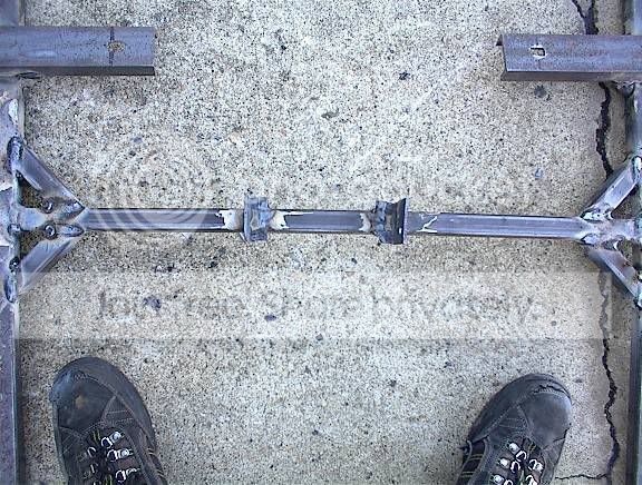

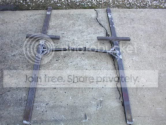

I have to say i was surprised myself when i found what people had said to be was true.. just getting into it i noticed a big difference from before putting them in... I included the seat bracing with mine, along with cross brace with an integrated driveshaft loop. since practically every track requires one, and is added safety even if that universal joint breaks..

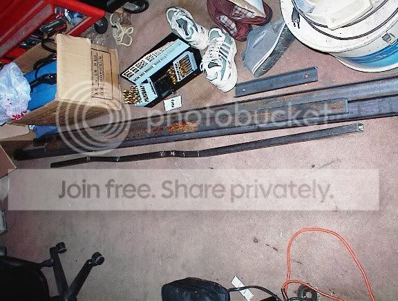

but enough bantering.. heres the pics from the project from start to fin... starting with the day i picked up the steel...

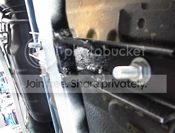

longer bolts and washers & nuts for the seat bracing

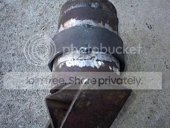

the enjoyment of using a school project to make the the driveshaft loop... glad i kept it...

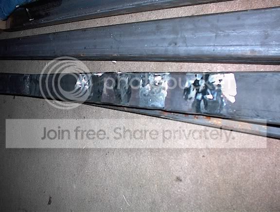

why hot steel is bad for your skin..

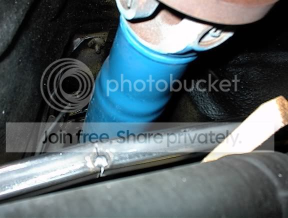

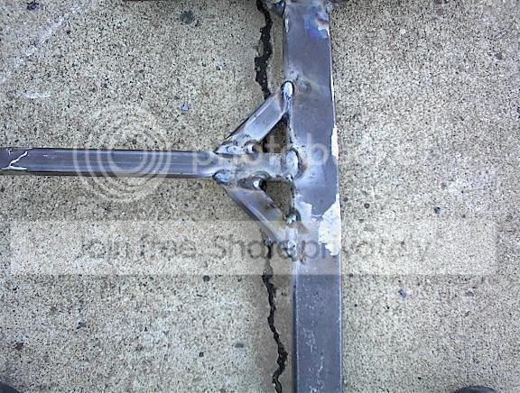

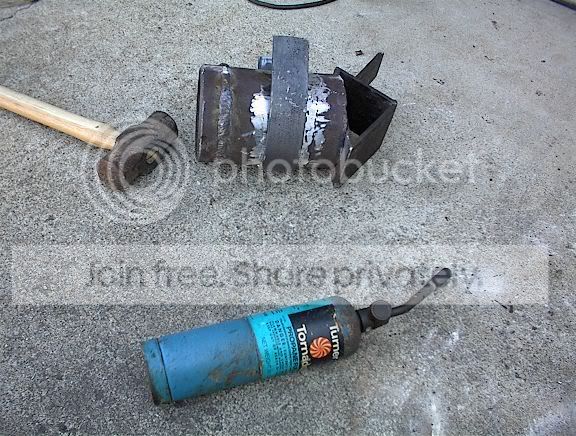

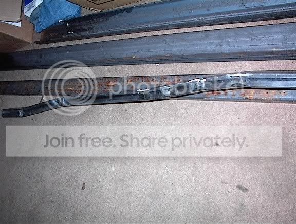

these were when i capped the ends of the pipes...

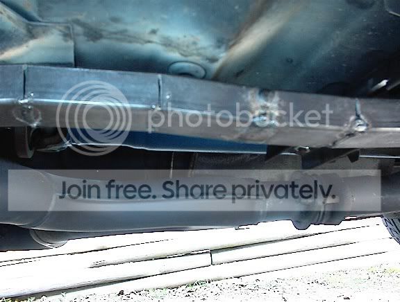

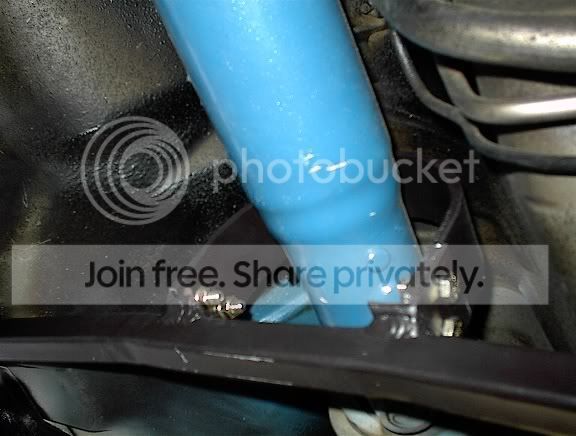

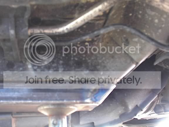

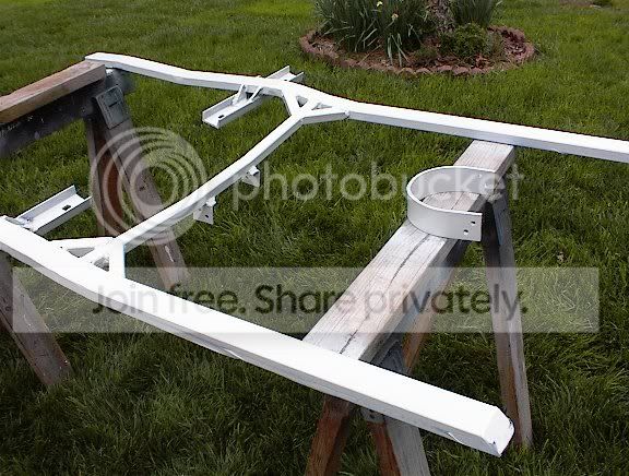

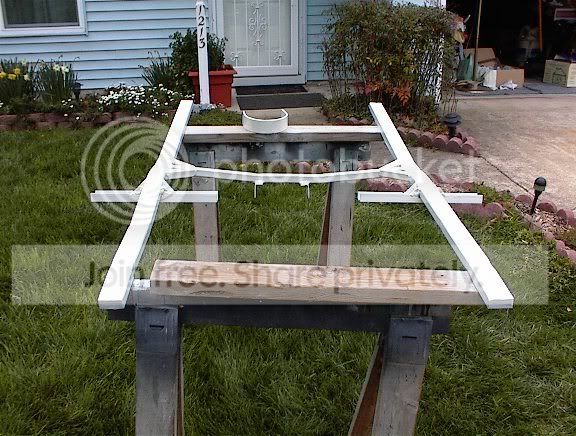

rust prevention 101... figured id get it primer painted cuz once i welded it in i wouldnt be able to hit the top.. and this way i got most of it done too.. i taped off the area where i planned to be welding too...

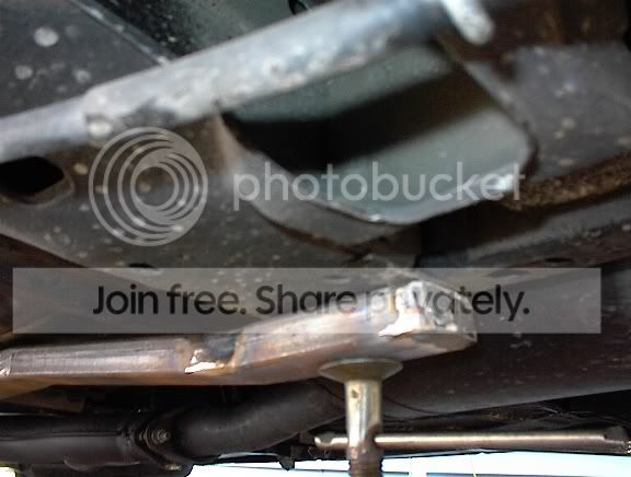

yeah im not happy with how the welds here look.. but theyll hold.. eventually when i get a mig ill go back and re-do them...

yup but that particular spot where its welded to the body i wouldnt smooth out till i could do it with mig.. mainly cuz the more reinforcement there it has the better itd hold for now...
may not always look pretty but definitely will hold..

1. They make a weldthrough primer, for future reference
2. If you are so inclined, you can make them even stronger by welding another connector to the rocker, and tying that into your main connector.
3. I, personally, never grind welds down

never knew they make weld through primer... i know theres rods out there that will weld through paint.. (have a few in the garage)
could you explain #2 though.. cuz when i think rockers i think rocker panels which are the out side trim just under the door.. which mine looks to be hardened rubber/plastic..
i feel the same on #3 depending on what im doing.. there are times its necessary to do so and times that its not needed.. most the reason when grinding is necessary is when there are close clearance tolerances that have to be met..

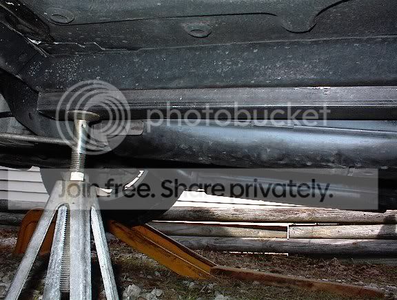

feel bad right now cuz when xplode was here we got it on the ramps and jacked up the rear end & suppoorted with jackstands to give me a little more room to work under there.. but the car rolled back and one of the mufflers landed on the jackstand and dented it pretty good :(.. when i looked at the one jackstand the pin that holds the locking tab in place seemed to have sheered in 2..cuz half of it was still stuck in the handle..

as long as you werent under it. it wasnt on purpose. im not mad. the mufflers are replaceable. shyt happens.
