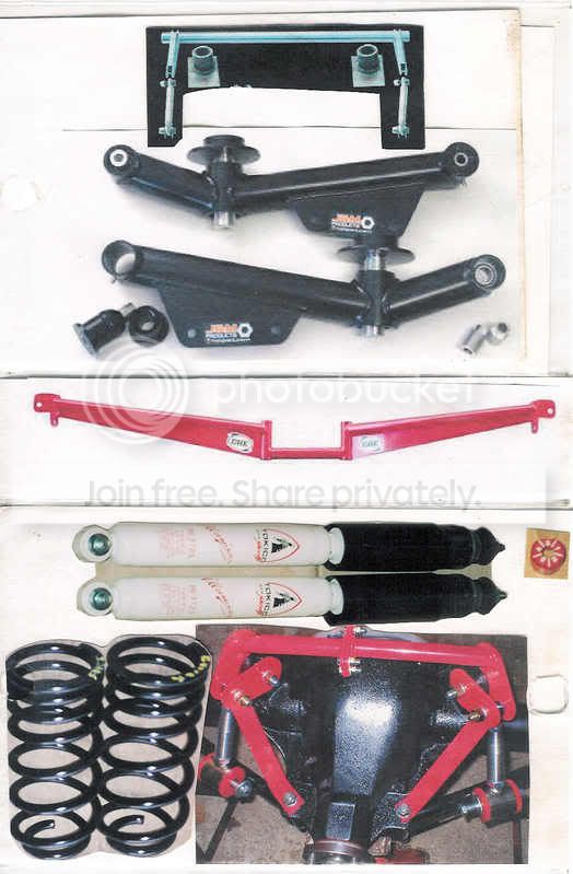

Suspension:
(Front)
Tokico Illumina 5 way Adjustable Drag Strut/ UPR Coil-Over Kit 150 Rate Springs
Fox Body A-Arms/ Maximum Motorsports Caster Camber Plates/ Stock "K" Member
(Rear)

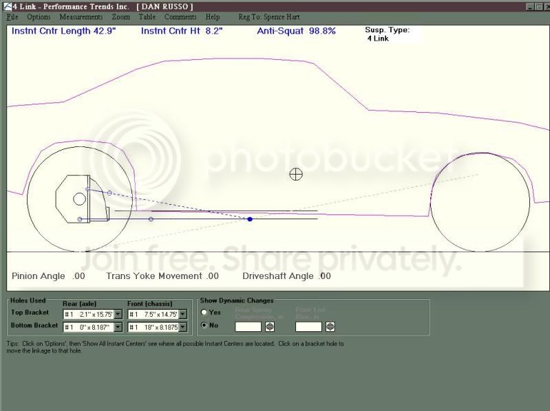

Baseline Suspensions Upper Control Arms (Street Launch PL#1)
J&M (Pro-Race) Weight Jacker Lower Control Arms
Tokico Illumina 5 Way Adjustable Shocks/ Stock Springs
UPR Anti-Roll Bar/ Kenny Brown Super Subframe Connectors

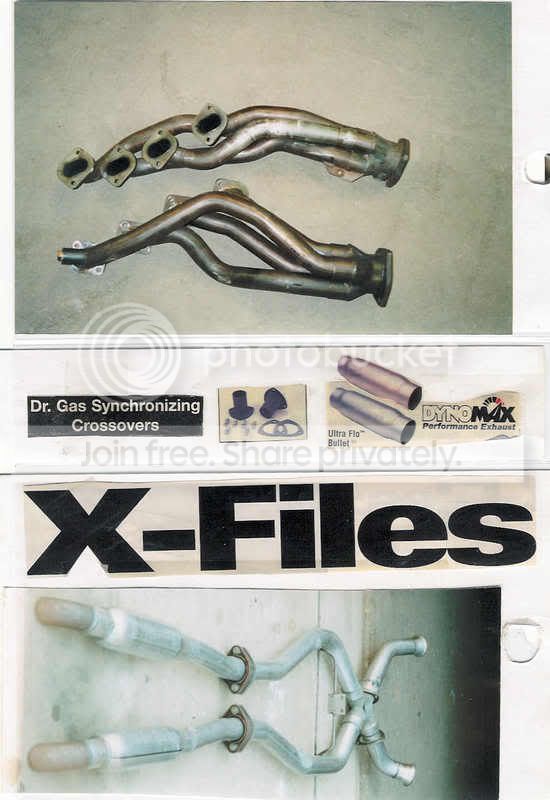

Watson's Mid-Length Proto-Type Stainless Headers 1 5/8" Individual Tubes(3" Collector)
Dr. Gas Exhaust Components Off Road "X" Pipe (2.5") & DynoMax Bullet Mufflers (2.5")

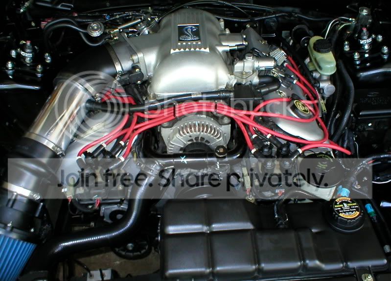

Motor:
4" Intake Pipe/ UPR Big Mouth Filter/ Pro-M 80mm Plastic MAF
FRPP Oval Bore Throttle Body/ Paul's High Performance Modified Stock Intake (Stage 2)
FRPP IMRC Deletes/ ASP UnderDrive Pulleys/ FRPP AC Delete Pulley/ Poly Motor Mounts
NGK#3951 Spark Plugs/ MSD 8.5mm Wires/ MSD DIS-4 Ignition Box w/ Tach Adaptors
Kirban Fuel Regulator/ 170 Liter FRPP fuel Pump/ JMS Auto Logic Chip (Mail Order)
5w30 Mobile 1 Synthetic Oil

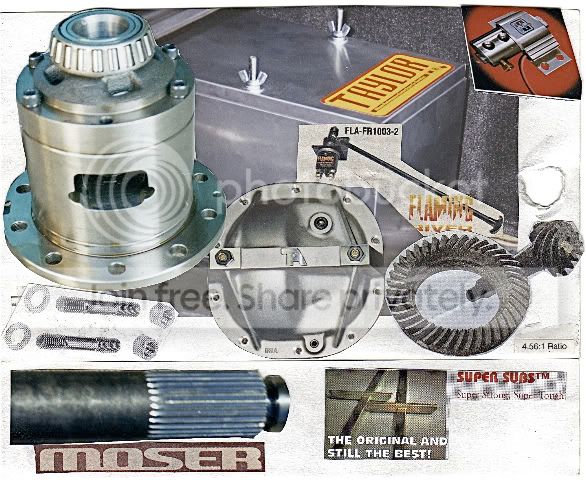

Rear End:
Stock 8.8 Housing/ FRPP 4.56 Ring & Pinion/ Detroit Trac-Tech "C" Locker/ ARP Stud Kit
Moser 31 Spline Axels/ TA Rear-End Girdle/ CHE Axle Brace/ Valvoline 85-140 Gear Oil

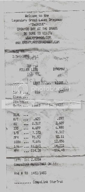

Track:
Launch@7000 RPM Off 2 Step/Shift all gears@6800 RPM/Cross Finish Line @ 6750 RPM
1/4 mile time 11.66@114 with a 1.51 60 ft. time/ 49 Degrees -500ft. Below Sea Level
Weight with Driver 3285 Lbs.
