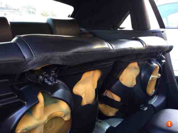

There was probably water in the rear behind the seat. The top forms a well that actually holds a shit ton of water. When you hit the brakes the water came forward through the rear seat. When my old top was leaking it was coming in around the back window glass and the liner filled up and I didn't even know until I heard it sloshing around.
Any idea how the rear seats in a 2005 come out? I'd bet there's still water in there...

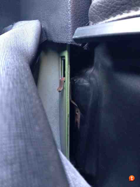

Also I drove with the too down, too went down fine, had to get out and persuade the top to fold correctly but that's it. Went to go out the top up and latch it and it comes short to the windshield a good 1.5"... Usually the motors will bring the top far enough to barely touch the weather stripping. Had to use all my weight to latch it. My sister was with me and she couldn't latch her side because she doesn't weigh as much as me.
I guess I know where one of the problems is LOL.

[MENTION=8243]Steve-Oh[/MENTION] thanks! I wasn't sure how to do it and I'm down at my grandmas at the moment. I just went out and looked at it. THERES YOUR PROBLEM!!!
