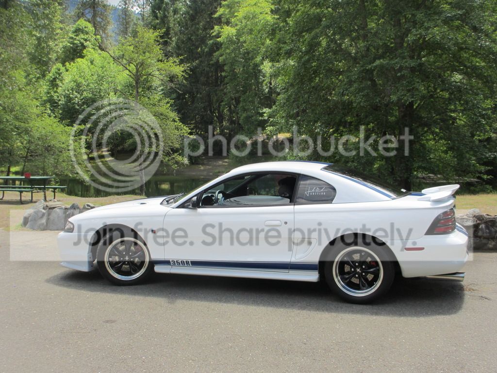

The Eibach Pro Kit Plus... springs, both roll bars, shocks & struts give a pretty nice stance. About 1.5" drop all around less than $1000 new.. or you can choose the sport springs & drop 2"....I have 315's on the back on 17" rims... no issues & did not roll the fenders. I would go Koni shocks & Struts or Bilsteins if the budget stretches...my Eibachs are still fine but the new Konis are better of course!
