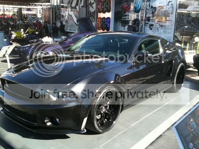

throw some silver pearl in your factory black color. door jams will never show unless they are in direct sun. heres a photoshop of the black i would like to 2-tone
Omg dude just when I thought your car couldn't get any sicker.. I think some ghost flames would be pretty sick, maybe green ghost flames :) Paint my calipers green too and bam..
Tony
May 23, 2012
9,397
985
ohio
lol, i painted my 88 s10 black with silver pearl in the clear. dude its the sexiest black i've ever seen. i never liked colored metalflake.
